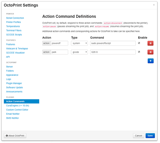

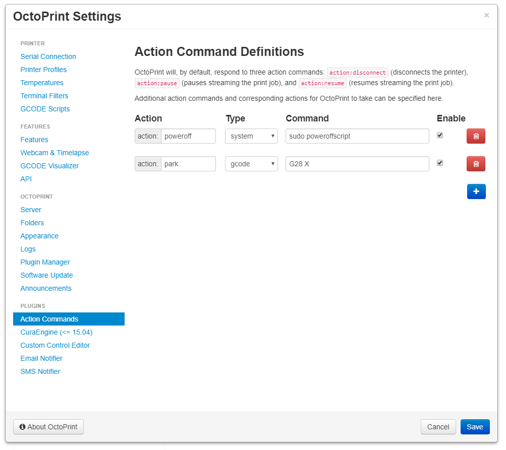

From Action Command Repo:
Set Ready
Use the "Set Ready" menu item on the printer to tell OctoPrint to start a new print.
(The "Set Ready" menu entry is only visible while the plugin is active.)
  • I've tested it and it works, so cleaning manually the bed, and clicking "ready" on the printer is starts active selected model. What is missing, that is simple list of models to print. Non time schedulance, no continius printing, just same list like it is on Prusa Connect.
