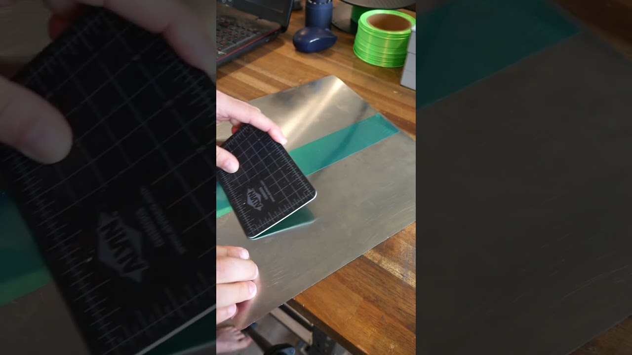

As it appears that SV06 has a sheet plate, you can try this:

"soup can" method is just placing a part under the x axis rods until either side is manually able to line up, does not seem to be the issue here. I will definitely try the tape method! Thank you!
