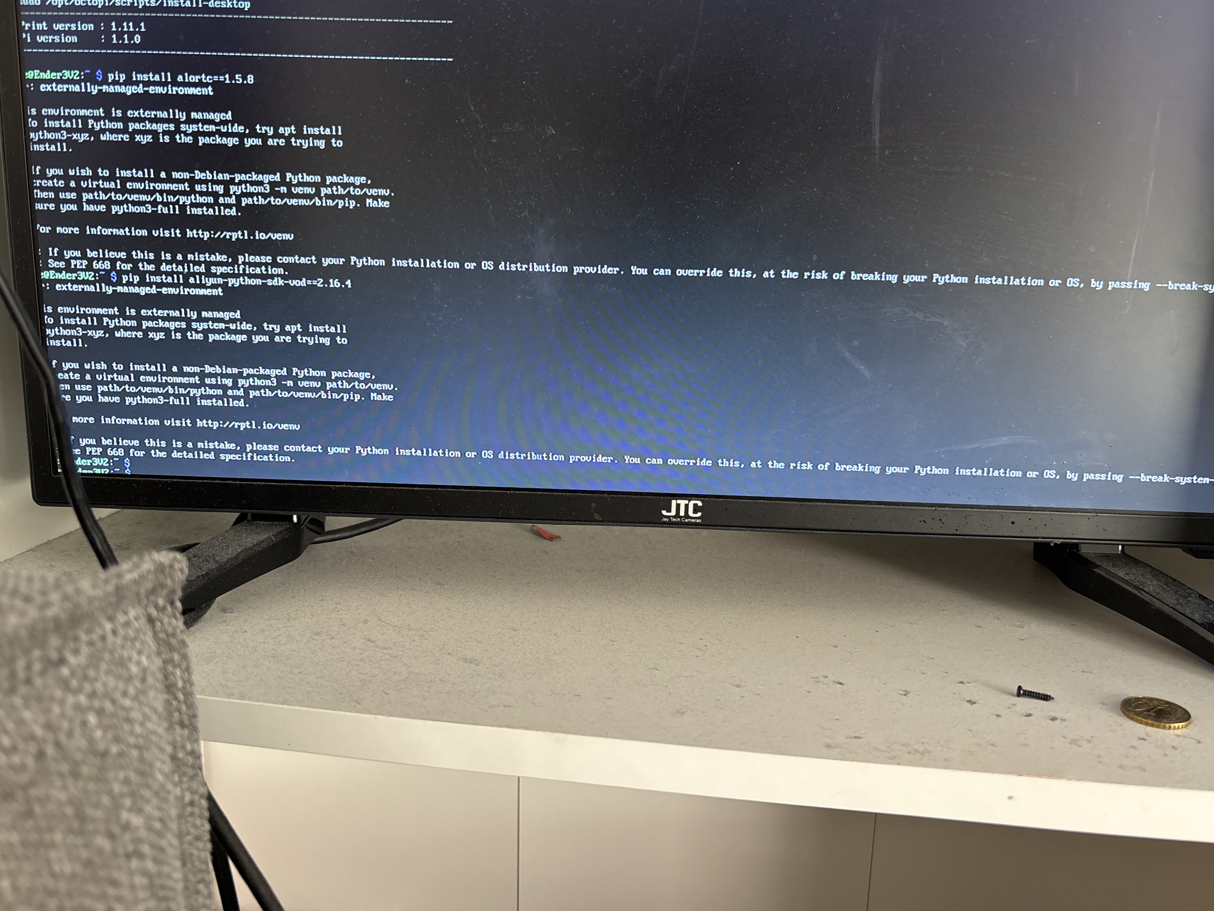

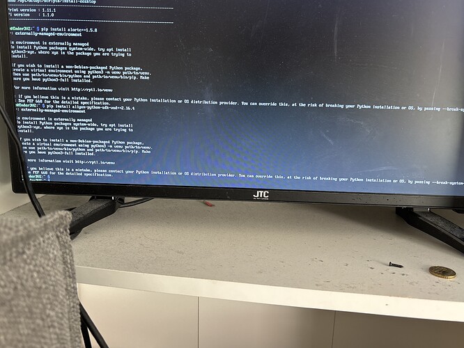

Pleasy help me i habe also some problems with the install
I have tried fixxing the problems but there are always this messages and i dont know what to do anymore
