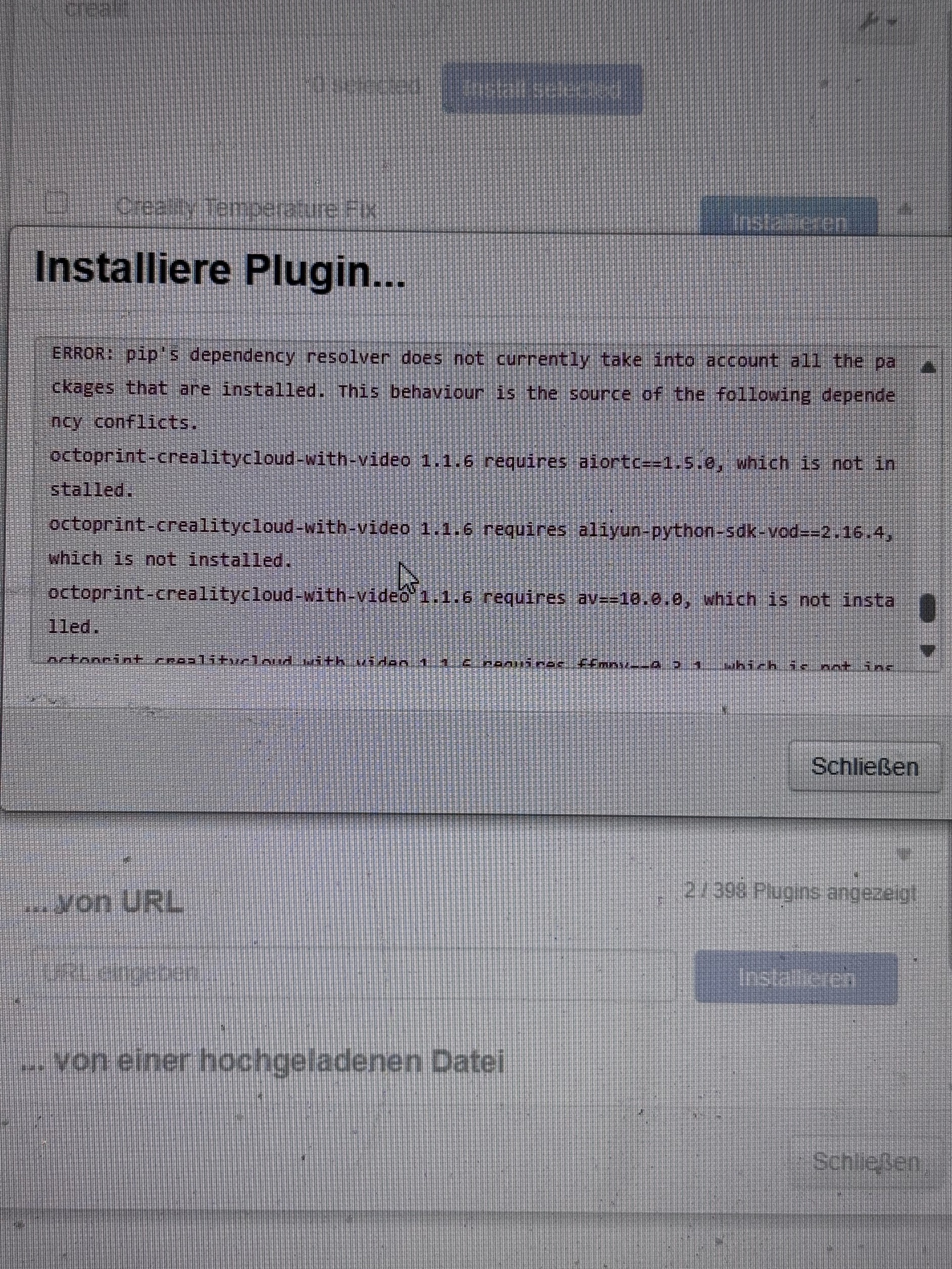

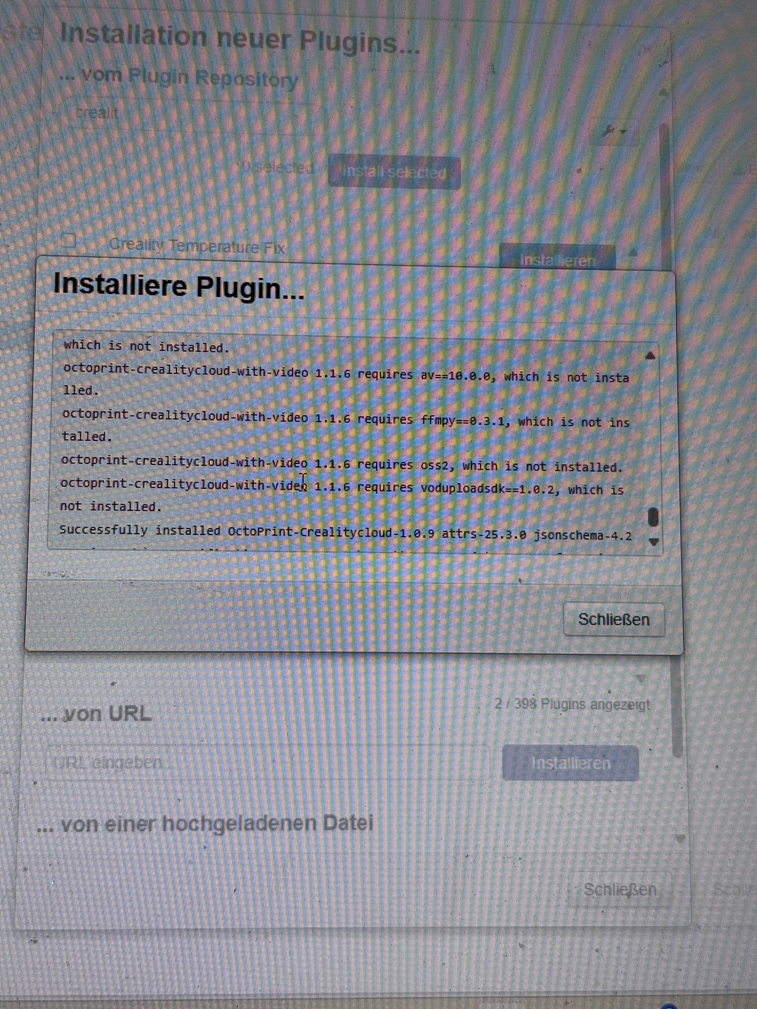

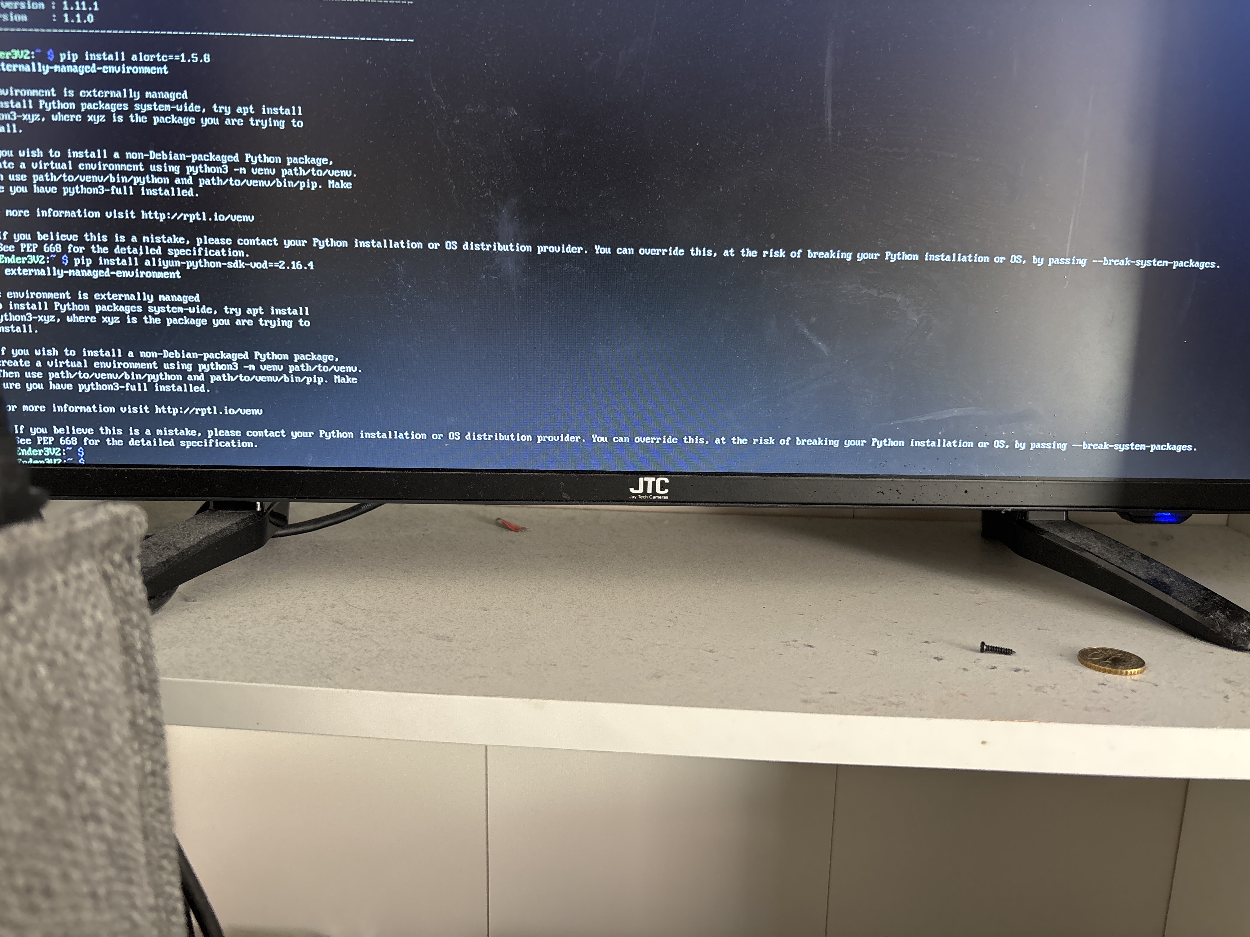

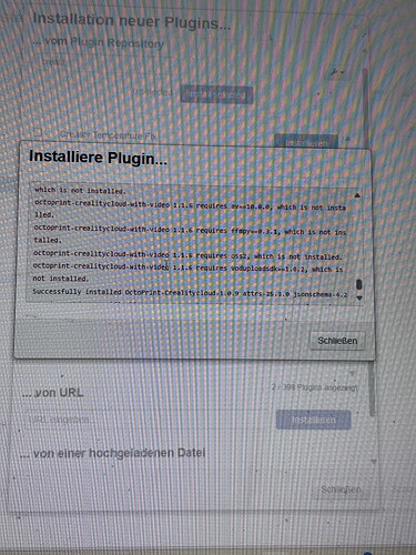

I always get these Errors when i try to install it and when I try to fix it i get other messages and i dont know what to do

The issue is related to all these missing dependencies of the plugin that are not specified here.
2025-05-30 16:31:14,010 ! octoprint-crealitycloud-with-video 1.1.6 requires aiortc==1.5.0, which is not installed.
2025-05-30 16:31:14,010 ! octoprint-crealitycloud-with-video 1.1.6 requires aliyun-python-sdk-vod==2.16.4, which is not installed.
2025-05-30 16:31:14,010 ! octoprint-crealitycloud-with-video 1.1.6 requires av==10.0.0, which is not installed.
2025-05-30 16:31:14,010 ! octoprint-crealitycloud-with-video 1.1.6 requires ffmpy==0.3.1, which is not installed.
2025-05-30 16:31:14,011 ! octoprint-crealitycloud-with-video 1.1.6 requires oss2, which is not installed.
2025-05-30 16:31:14,011 ! octoprint-crealitycloud-with-video 1.1.6 requires voduploadsdk==1.0.2, which is not installed.
to resolve you might be able to SSH to the pi and run these commands to resolve.
/opt/octopi/oprint/bin/pip install aiortc==1.5.0
/opt/octopi/oprint/bin/pip install aliyun-python-sdk-vod==2.16.4
/opt/octopi/oprint/bin/pip install av==10.0.0
/opt/octopi/oprint/bin/pip install ffmpy==0.3.1
/opt/octopi/oprint/bin/pip install oss2
/opt/octopi/oprint/bin/pip install voduploadsdk==1.0.2
but there's no guarantee that this will work. I suspect the issue might be the newer Python version (3.11) that is in OctoPi 1.1.0 that you are facing and those python modules may not be compatible, etc.

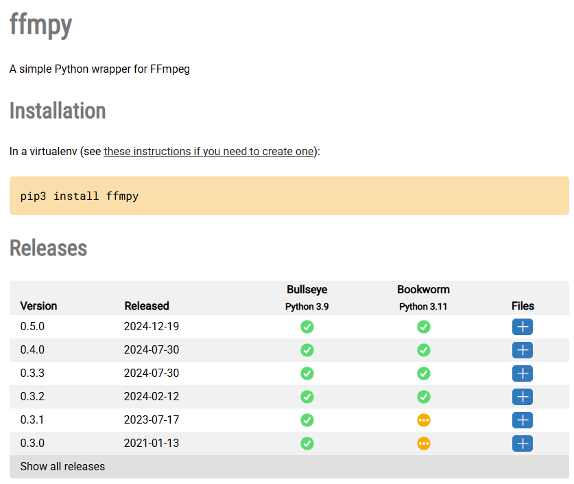

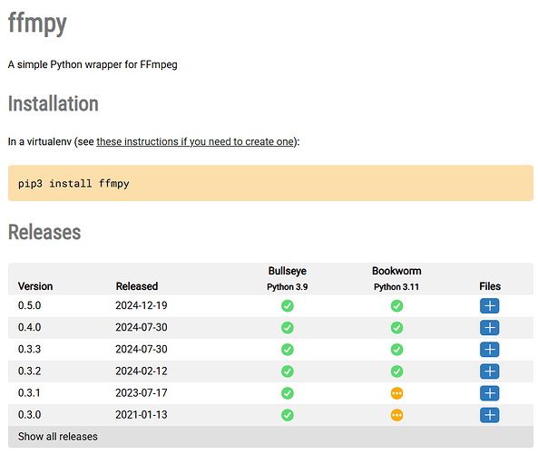

and it actually looks like they do have the plugin_requires setup properly, but again, probably a Python 3.11 incompatibility issue.
Quick check seems to coincide with that assumption. For example...
https://www.piwheels.org/project/ffmpy/
Notice only buids for python 3.11 on versions 0.3.2+ (plugin is asking for 0.3.1).
THANK YOU I installed the 0.3.1 software and now it works
