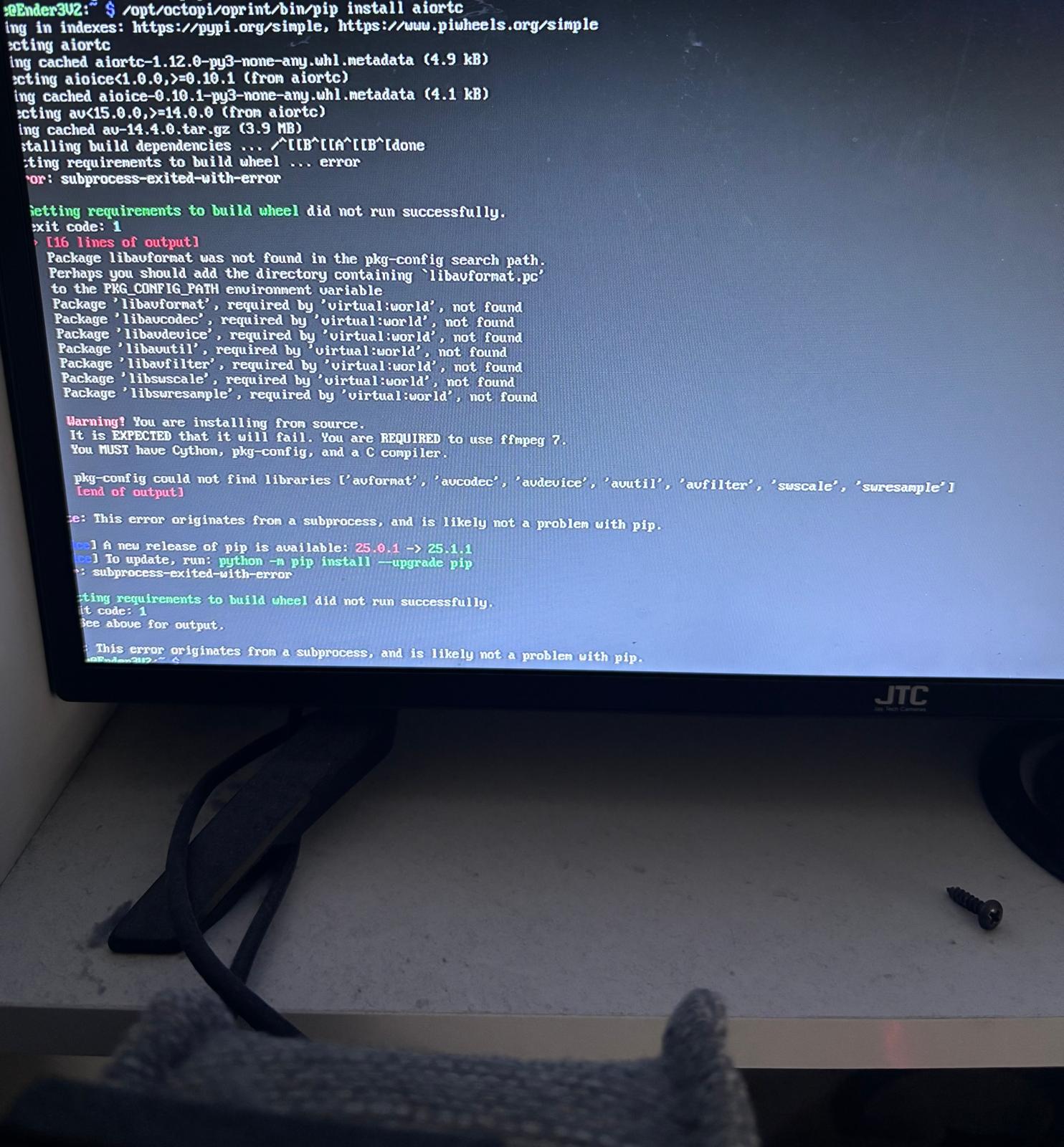

maybe a little bit late here but i just installed octoprint, everything works but now i wanted to download the creality cloud plugin but in the last step it says copy the Key file to the creality cloud plugin, but the plugin doesn't show up under the plugins section, i did the ~/oprint/bin/pip install aliyun-iot-linkkit comand and it downloaded it but even after a restart it still doesnt work, pls help

I did the command but it did not work after the restart
It didn't work because it didn't install, there's obvious errors during the process. You have to figure out which system dependencies from that list to apt install the right library and rerun the pip command.
