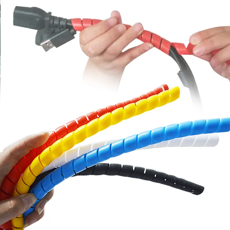

I'm planning on using the "Serpentine cable management" for the X cable management and the hot bed cable management. Then some of the "Coiled-tube sleeve cable management" for the other loose wires that are now zip tied but still somewhat messy.
