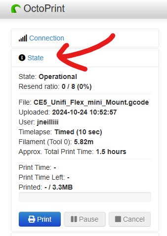

Hi, How do I remove a print file from the state section without having to switch my printer off then on again. I selected a wrong file to print but no matter what I do I can't find a way to change it to the correct file without switching the entire system off then on again.
Hello @astroman673 !
Can you attach an image?
They are referring to the state panel...
Typically just selecting another file in the file list will change the selected file, as long as the current state is Operational.
