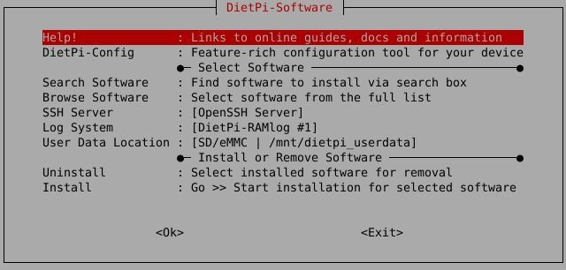

To install any of the DietPi optimised software itemslisted below run from the command line: dietpi-software
Choose Browse Software and select one or more items. Finally select Install.
DietPi will do all the necessary steps to install and start these software items.
DietPi-Software menu screenshot
To see all the DietPi configurations options, review the DietPi Tools section.
