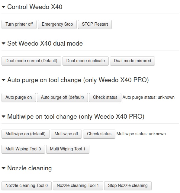

We have it created with Custom Controlls for the Weedo X40 Idex printer
http://www.x40-community.org/images/x40/OctoPrint/Octoprint_Weedo_X40_Control.jpg
