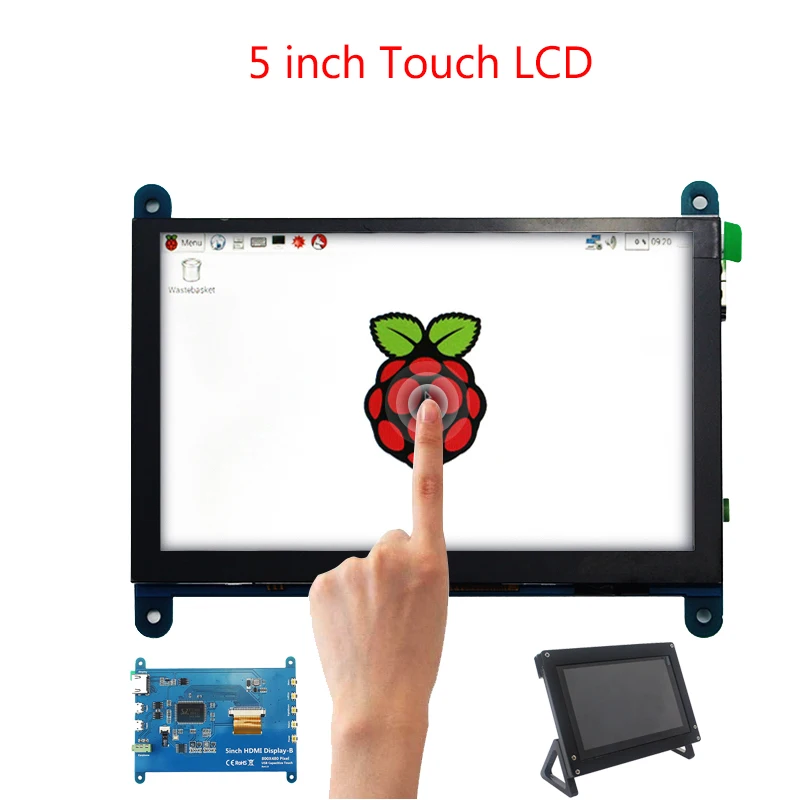

What type of screen would you recommend to me.
If you are going to try to use the same mod as Jerlo, he states that it is only compatible with Kuman screens. I have Octoscreen running with a Chinese 5" 800x480 capacitive-touch screen (hdmi) and like it a lot. https://github.com/Z-Bolt/OctoScreen

Your tutorial indicates that this 5" screen is what they're talking about.
Personally, my (different) printer has a small 3.5" screen and I've replaced that with a 10.1" SunFounder.
Yes, that is sold under a bunch of different names. It uses HDMI for the video and a usb connection for the touch part. The hardest part is 800x480 is not a standard VESA resolution, and you have to make an entry for it in the Xorg configuration. If I wasn't so strapped for money, I would have gotten a 10-inch one. Plus I have three printers to feed :smiley: ... I will try to find the resolution setup I used if you want to try that one. Also Chris Riley (Chris's Basement Youtuber) has an excellent video on setting up Octoscreen on a 5" display. If you search for "5 inch raspberry pi touch display" on Amazon, you will get lots of hits for the display.
@Avarax none of these Chinese screens have good documentation or videos. So as long as they have drivers for Raspberry Pi buster, they will work. By default they come up in 640x480 mode. The article on how to make 800x480 work is here https://www.raspberrypi.org/forums/viewtopic.php?t=154961
I highly recommend you watch Chris's video. It was very useful for me in setting up Octoscreen.

Sorry, My German is not good enough to shop on Amazon.de. Any touch screen that works with current raspberry pi can be used. Best choice is capacitive touch and hdmi connection. I cannot be responsible for your choice. I can only advise of what worked for me.
And which are they?
Any touchscreen that uses usb to communicate touch and HDMI to deliver video. This way you are using native pi tools rather than some Chinese guy's driver written for some other linux system. Sorry for the delay in answering, I've been heads down rebuilding a printer.
I used the Adafruit documentation to setup the 800x480 resolution on the 5in screen.
