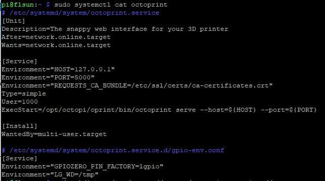

so in theory...
  • Step 1: SSH to pi
  • Step 2: Run these commands to add the service overrides
    sudo mkdir -p /etc/systemd/system/octoprint.service.d/
    echo -e '[Service]\nEnvironment="GPIOZERO_PIN_FACTORY=lgpio"\nEnvironment="LG_WD=/tmp"' | sudo tee /etc/systemd/system/octoprint.service.d/gpio-env.conf
    sudo systemctl daemon-reload
  • Step 3: Validate the override
    sudo systemctl cat octoprint
  • Step 4: Stop the service, reinstall the dependencies, start the service
    sudo systemctl stop octoprint
    source ~/oprint/bin/activate
    pip install --upgrade lgpio
    pip install --upgrade gpiozero
    deactivate
    sudo systemctl start octoprint

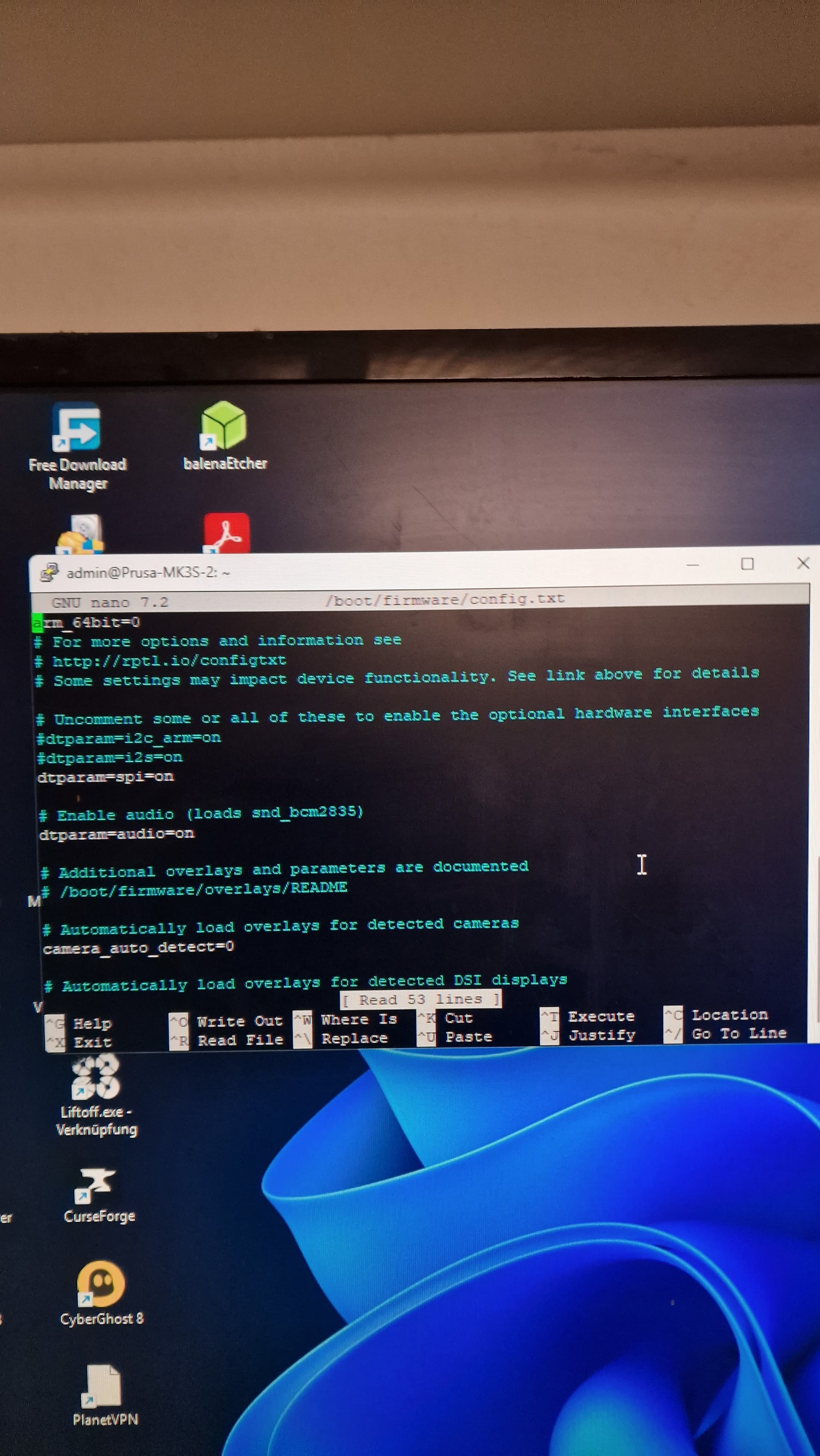

do i need to change anything here?
any errors in octoprint.log this time?
