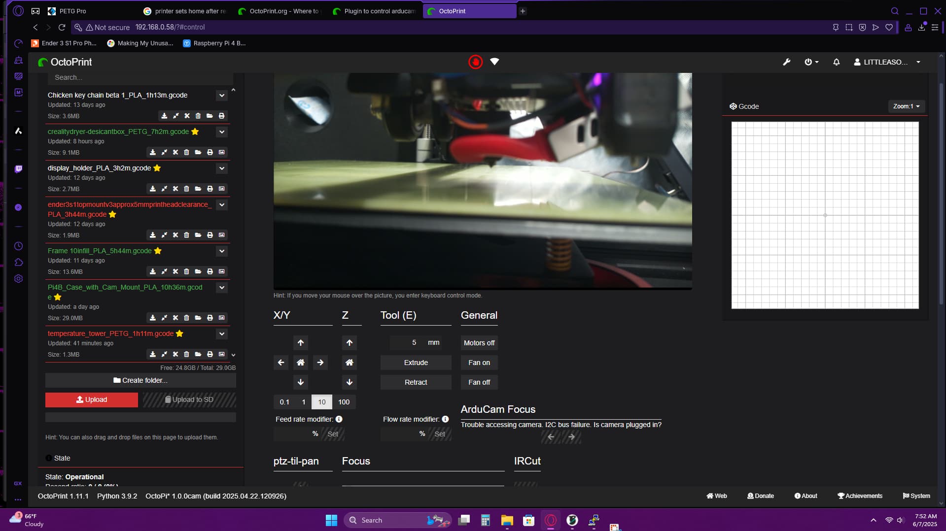

i have a arducam imx708 auto focus and i about a week ago i just got it to work with octoprint with google ai (works well) but now im trying to use this focus plugin and im getting a i2c bus error i did follow some othe guides here but honesty i dont know any of this and need help
might help to share your system info bundle so we can see the same error you see. did you raspi-config and enable i2c? which exact camera?
Here is my system info. yes i have 12c enable that was my first problem after i fix that i got this error and i link the exact model camra i bought. thanks for the help

Ok, that camera's focus is automatic, but might be possible to control via libcamera options for camera-streamer plugin.
