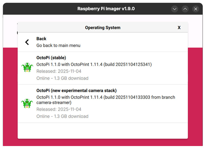

Camera-streamer configuration on the new experimental camera stack for OctoPi
:raised_hand: Got an issue with the new camera stack? Open a new topic!
If you are running into any issues with the new camera stack of which the configuration is described below, DO NOT REPLY TO THIS TOPIC, open a new one please. This is a documentation topic, not a support topic.
An alternative OctoPi-UpdateToDate build replaces mjpg-streamer and webcamd with a new camera streaming setup based on camera-streamer. This build can currently be found as "OctoPi (new experimental camera stack)" in the RPi Imager:
It is currently still deemed experimental as there are some blocking issues with it (crashes, Raspberry Pi 5 incompatibility for libcamera based cameras like the RPiCam) and it might yet get swapped for another approach if those issues can't be resolved.
camera-streamer supports libcamera based cameras incl. the RPiCam v3 and newer ArduCams, as well as USB cameras. The setup on the OctoPi image allows easy configuration of camera parameters through configuration files in /boot/firmware/camera-streamer (or the camera-streamer on the root of the card if is used as a thumb drive), hot-plugging of USB cameras and also includes multi-cam support.
