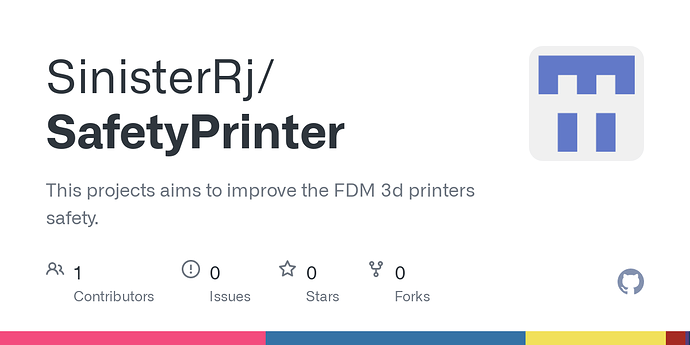

Care to link the source? Without it's just grasping at straws.
Here is a simple plugin that adds an icon to the navbar that might be a good reference.
It's here:
Thanks for the help. I checked your plugin and now its working. It seems that if you make any mistake on the jinja file, i.e. trying to bind one knockout variable to a property that in not applicable to the HTML object, you can have this erro.
But also i figured out that your plugin dont use "dict(type="navbar", custom_bindings=True)," init.py and in my plugin it also returns the same error (when I uncomment that line).
