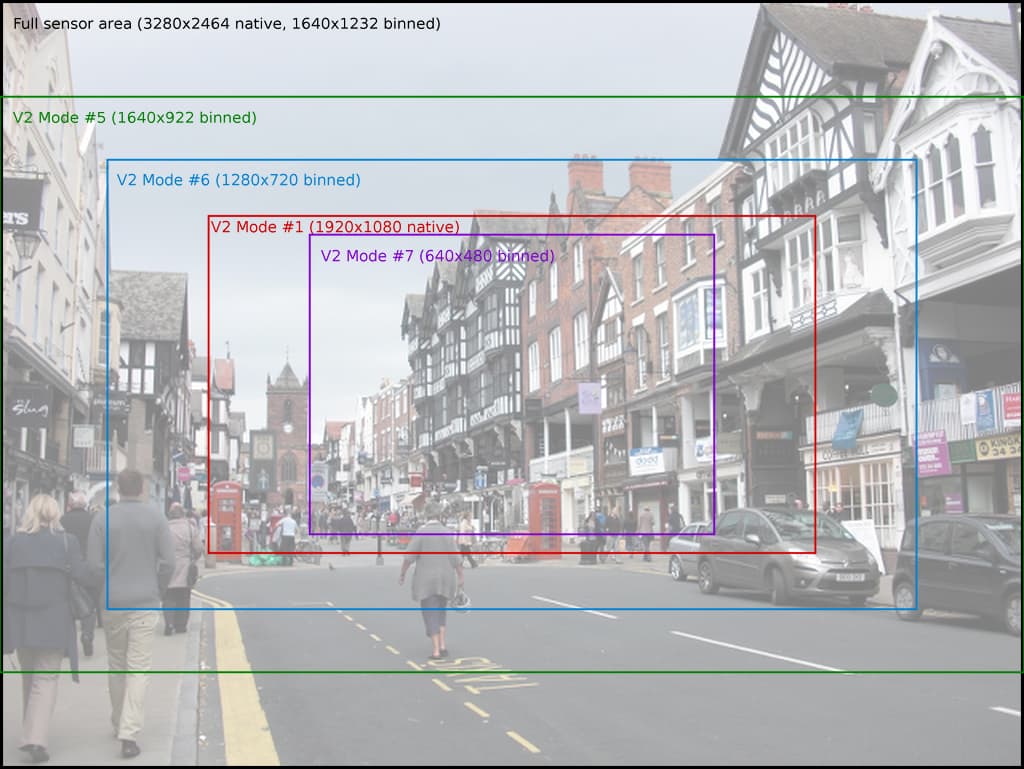

Remove the # from (only) one of those lines and type sudo service webcamd restart. You can check the current status with sudo service webcamd status. Some of these options might not work.
I got the data above from here. Scroll down to the V2 image (copied below) to see how the changes effect the FOV.

Ok ,I got it to change resolution-thanks.Only thing is that if I try 1920x1080,picture is even more zoomed.1280x720,640x480 and 320x240 have pretty much same zoom with 1280x720 filling full screen (I believe in 16:9) and those other 2 have black side edges (shrunk to 4:3).Maybe it’s my camera but seems like whatever I do I can’t zoom it out.Might have to relocate camera after all.Thanks for all your help,I really appreciate it
