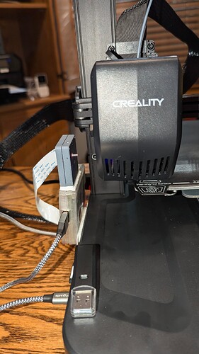

This is how I decided to mount mine. Hasn't gotten in the way and if you were trying to tap into power it's in a decent spot. I remixed someone else's cable clip to make this one.

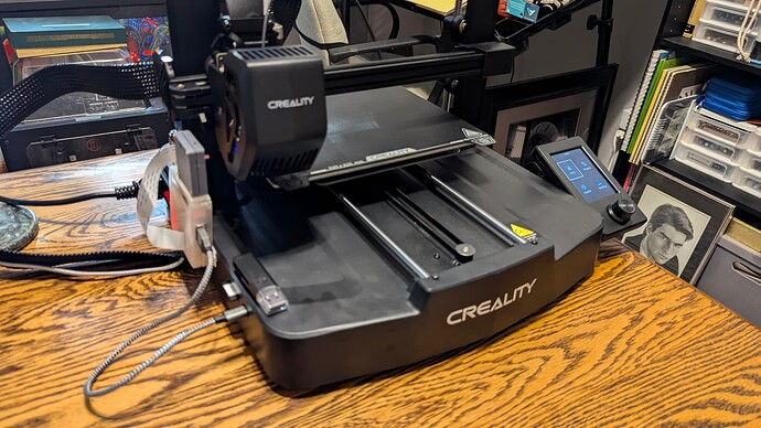

Regarding how I mount my Raspberry pi and camera. I just use the Command 17206 picture strips. It makes a sturdy mount and it is easily removed or moved whenever you want.
