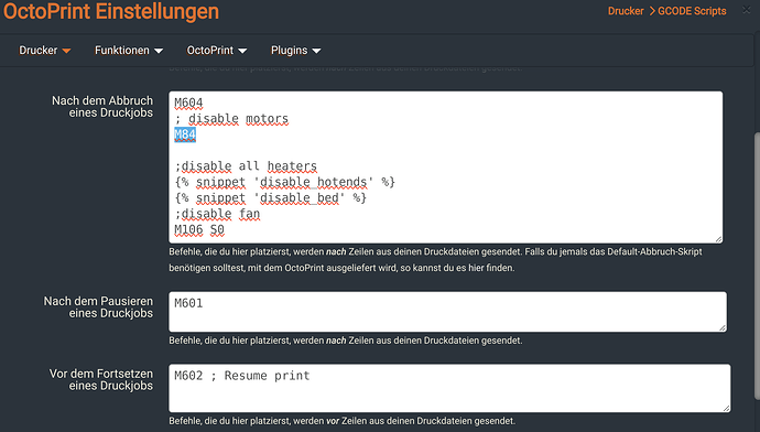

Hi, I have been using OctoPrint with my MK4 since it arrived in mid-April last year. In the beginning it was not "officially supported" by Prusa and the filament run-out sensor did not work. But I managed to work around that drawback. After the release of firmware 5.1, when Prusa claimed "initial support" for OctoPrint, the filament run-out sensor as well as pauses for color changes or manual MMU prints did work for me. Apart from the missing progress info on the printer's display OctoPrint on the MK4 works just the same for my use case as on my MK3S+, which I still have and use.
Are you sure that you did insert all the gcode scripts into the settings for the printer profile?
Thanks for this. I did insert them but I put the M604 at the bottom and not the top of the gcode section. Which firmware version are you using please? My printer came with 6.0 and I upgraded to 6.0.2/

My MK4 is on firmware 6.0.2. I did not notice any difference in behaviour to the version before that. The settings in the screenshot are what I have been using since firmware version 5.1.x.
