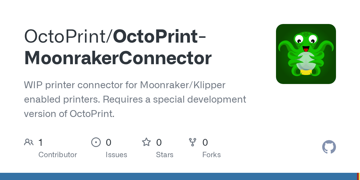

I've been spending most of this year implementing a new plugin API to allow adding connectors for different protocols, and the first such plugin is
That will use the Moonraker API that has to be exposed on such printers for any of the other web UI options to work.
Goal is to merge the changes necessary for that to dev this week or next, and push out everything with 1.12.0.
