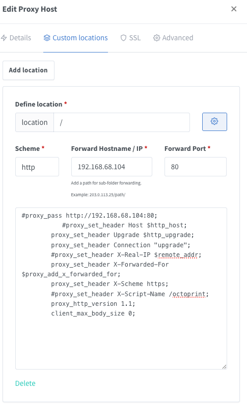

Has anyone managed to get it working with NPM plus?
Struggling to get anything working from the GUI
Does anyone have a good working example of getting this working in NGINX Proxy Manager with the WebUI? I had it working, then had to reflash my SD because of Python. Now it's not working. I get "net::ERR_CERT_AUTHORITY_INVALID" when trying through NPM.
I did enable CORS. I see posts talking about getting it working but it's all text configs, I am using the WebUI of NPM.
Thanks
I was struggling with this and found some things about NPM Nginx Proxy Manager
  1. NPM set's proxy pass and a few headers when you enable the host, so adding them will cause offline error.
  2. Don't use the 'enable websockets' slider, we'll set the required headers ourselves.
  3. I don't think required, but ended up using IP instead of remote hostname.
proxy_set_header Upgrade $http_upgrade;
proxy_set_header Connection "upgrade";
proxy_set_header X-Forwarded-For $proxy_add_x_forwarded_for;
proxy_set_header X-Scheme https;  # hardcoded as https
proxy_http_version 1.1;
client_max_body_size 0;
# Don't set these (commented out)
#proxy_pass http://192.168.68.104:80;
#proxy_set_header Host $http_host;
#proxy_set_header X-Script-Name /octoprint;
#proxy_set_header X-Real-IP $remote_addr;
