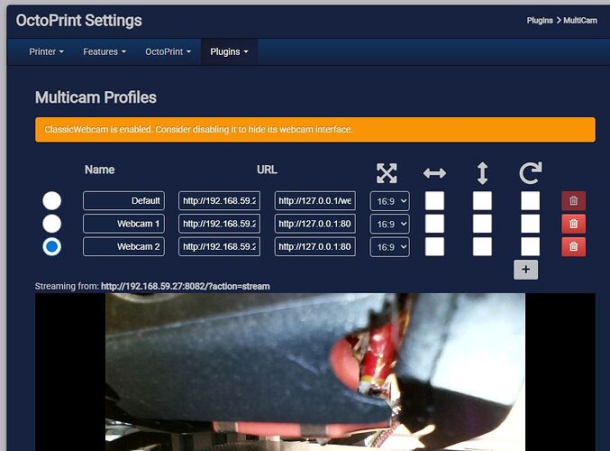

Ok,
So I have all 3 working now on the latest version that I restored a backup to a few days ago.
(Not using the Clean Build SD Card right now).
All Visible on my PC at:-
http://192.168.59.27/webcam/?action=stream but not http://192.168.59.27:8080/?action=stream
http://192.168.59.27/webcam2/?action=stream and http://192.168.59.27:8081/?action=stream
http://192.168.59.27/webcam3/?action=stream also http://192.168.59.27:8082/?action=stream
But,
In Octoprint Multicam, I can't access them at 127.0.0.1 or localhost.
They do work there though if I specify the Pi's IP address in the URL.
Edit:- I do wonder if the behaviour is related to the code in haproxy.txt,
While I don't quite understand it, I see things like forwardfor,
and v4v6, which I presume references IPV6, which I've seen cause other local issues in different cases.
frontend public
        bind :::80 v4v6
        bind :::443 v4v6 ssl crt /etc/ssl/snakeoil.pem
        option forwardfor except 127.0.0.1
        use_backend webcam if { path_beg /webcam/ }
        use_backend webcam_hls if { path_beg /hls/ }
        use_backend webcam_hls if { path_beg /jpeg/ }
        default_backend octoprint
This is what I was referring to when I mentioned adding the relative URLs, see the section from the original post OPTIONAL: Haproxy configuration.
I Do Believe I have haproxy setup fine as it appears to be working as mentioned above.
(Note:- I haven't edited the Snapshot URL's & they do not work).
Cameras available as /webcam/, /webcam2/ etc in my PC's Browser.
It's the fact that the Pi can't see its own cameras on 127.0.0.1 or localhost that is different.
Yet it can see them addressing it's own IP address.
My Full haproxy.cfg is as follows.
