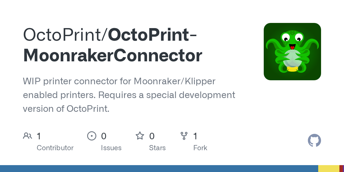

I've been using it with the development version of OctoPrint 1.12.0 and a moonraker plugin and it can connect and monitor prints, etc. So, it's not too far around the corner for initial release candidate stage sometime after the beginning of the year. Gina was developing it against her Qidi and it just worked for me with my U1. There's still much development to do, but there is someone else contributing to the moonraker plugin as well to allow it to be as full featured as possible, but Gina is on well deserved vacation until beginning of the year. Haven't had a chance to test the camera capabilities yet but I know the U1's camera in fluidd;s web interface built-in to the printer is also not present.
Which moonraker plugin are you using?

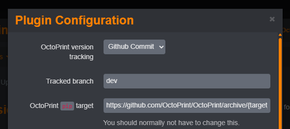

Like I mentioned, it would require using github commit on the dev branch. In Software Update, click the gear icon in the top right and change it like below screenshot. Bear in mind, this can break some plugins from working if they depend on OctoPrint version numbering.
Yapp. Works nice!
