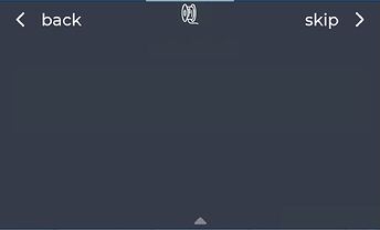

Only Main Difference I see between my working setup of OctoDash 2.3.1 and the 2.6.2 on the Test Pi is that When you Touch the Filament Icon on the Test Pi, it first asks you for Tool0 or Tool1, then goes to the empty filament list.
On the Working Pi Touching the Icon takes you straight to the Filament List.

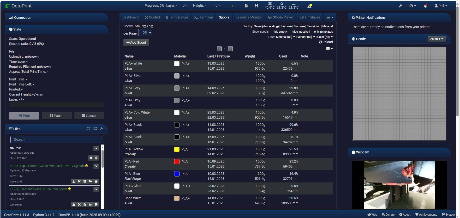

This is OctoPrint on the Test Pi. There are 12 Rolls Present...
But in OctoDash on the Test Pi...
