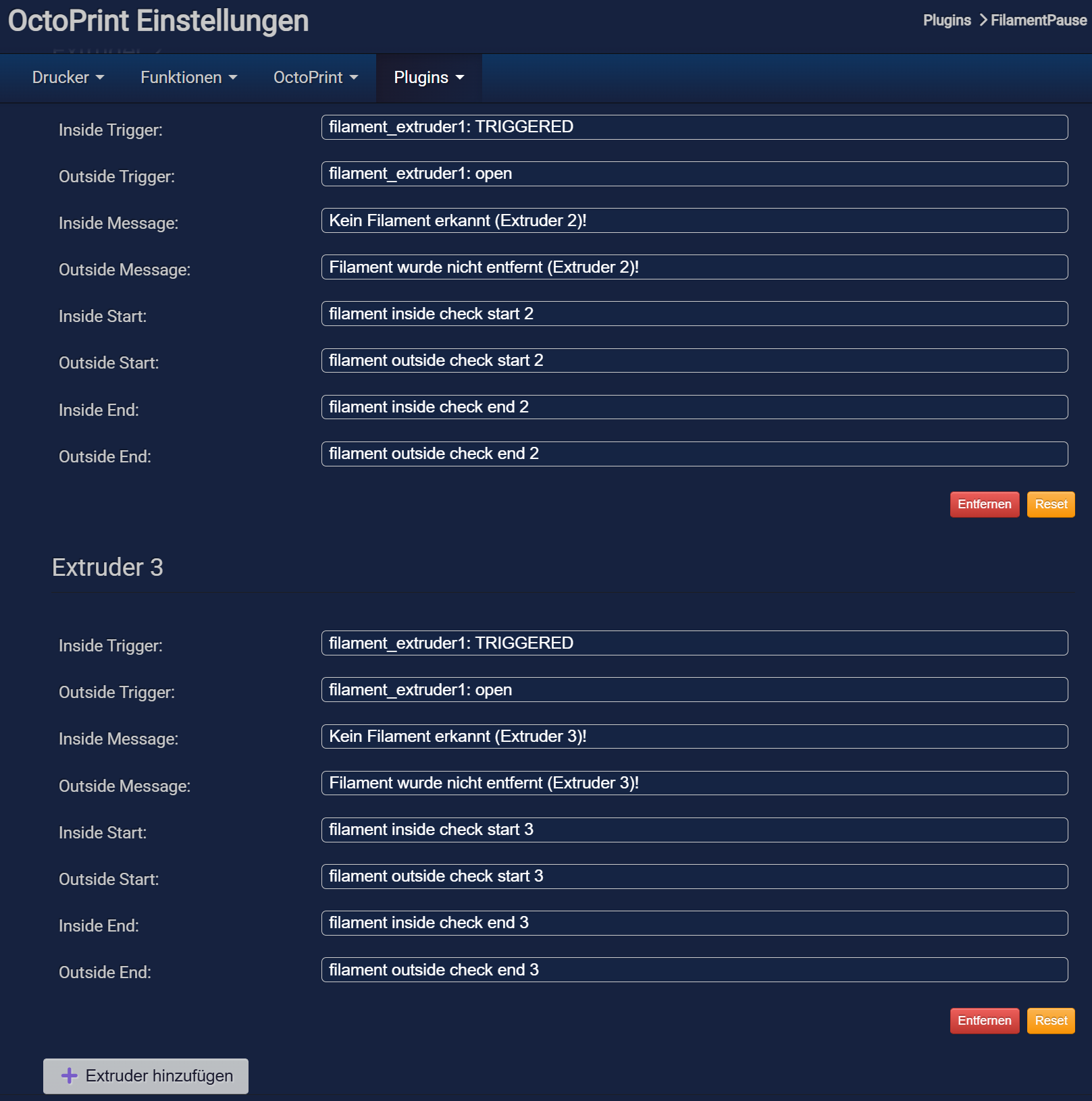

I drew a settingspage in the meantime and added functionality.

OK, if somebody is interested, here is my "final version":
Settings page with individual messages:
filamentpause_Full_Settings.zip (3.3 KB)
