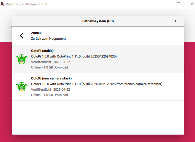

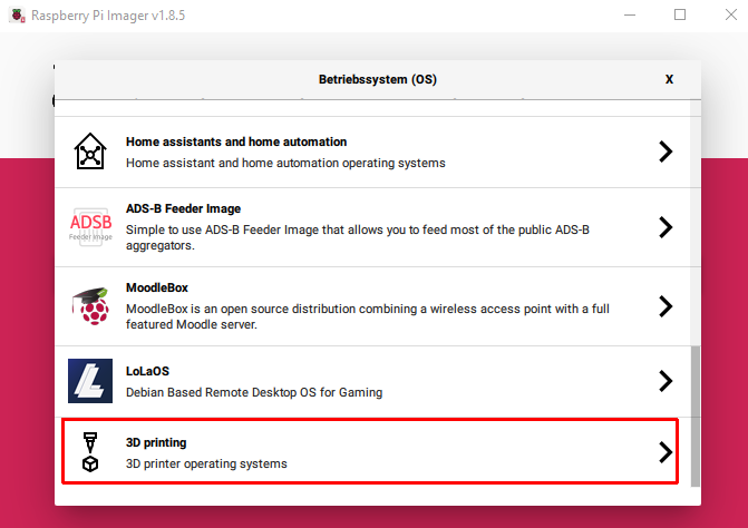

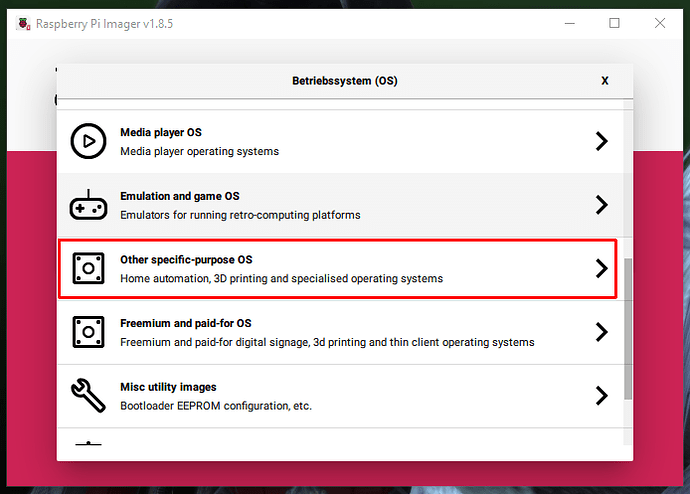

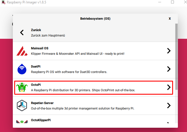

On the Raspberry Pi Imager, you have to choose the correct image.
grafik
grafik
and the one of these:
grafik
OK, I never seen those choices but now I do. I am making a new SD now, I'll let you know in about 10 minutes.
