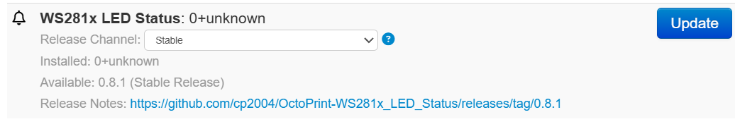

I've just submitted a PR. Unfortunately, the way that Charlie does his version/release method you can't just install from my fork directly without the plugin thinking there's an update.
It should still work with this URL in plugin manager > get more > ...from URL
https://github.com/jneilliii/OctoPrint-WS281x_LED_Status/archive/refs/heads/bugfix/bookworm.zip
just don't update to version 0.8.1 when prompted.
