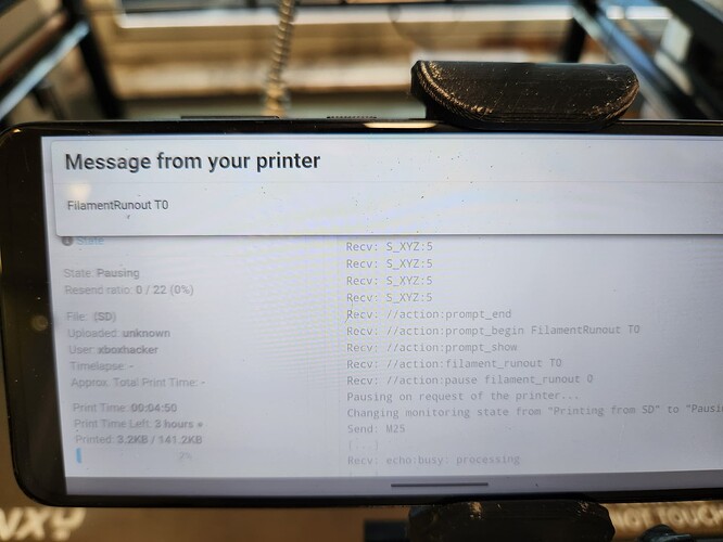

There is still an issue with printing from SD with runout and pausing.
But now I am able to trigger a runout from UI printing. But the notification that the Filament T0 runout is always present. Have to do some more digging.

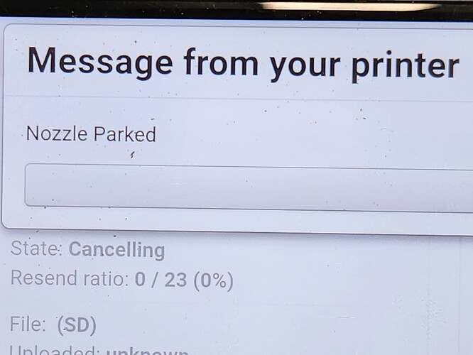

Still having this canceling issue with SD printing.
Question: When starting a print from the SD, from the UI, should the LCD display printing information? Mine is just the home screen on the LCD.
But here is another problem. The place with the printer has no internet. So I am using a Moto One 5g with Octo4A and Octoeverywhere. This way I can monitor (also with AI) my prints, which are all over 24hr ea. So I cannot use a Pi like a normal setup. I need to print from the SD because if I print from the UI octoprint "stutters" and the print gets jacked up. So printing from UI is a NOGO.
Since this topic is getting no where, I did tons of testing and I am now able to print from the UI with "virtually" no issues. So now the need for SD printing is a moot point. But there is still a bug issue with the printing from SD canceling status on runout and pause....
