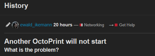

You put it into the Get Help Networking sub-forum.
grafik
My question was: How/what did you use to install OctoPrint to the KIAUH installation?
I clicked on a button that said "Get Help", unsure how i got to networking, but if it makes you feel better, i am truly sorry. it wont happen again, i promise.
