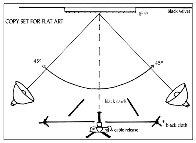

You may improve the lighting.
As it can be seen on the image above, the light partially shines into the camera. That messes up the image.
Take care nor direct or reflected light shines into the camera.
Best position is from behind the camera. somehow like the picture below.
