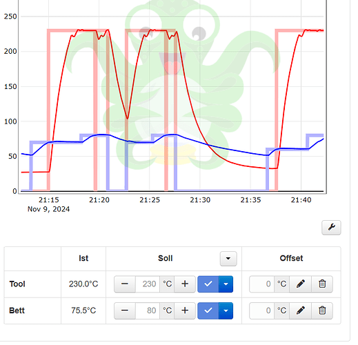

Can you take a screenshot of the temperature graph which shows the 80 degree temperature?

I suspect that the PID values for the bed are wrong but since this is a Creality printer, anything is possible. We should be able to help you tune the PID values after we see the graph.
PID seems to be fine.
It gets the target temperature.
But as soon as the nozzle is at target temp, bed temp gets set to 80°C
Whenever i try to manually disable the target temp, it gets set back to 80°C
This seems to be different for the gcode file you attached in your first post.
