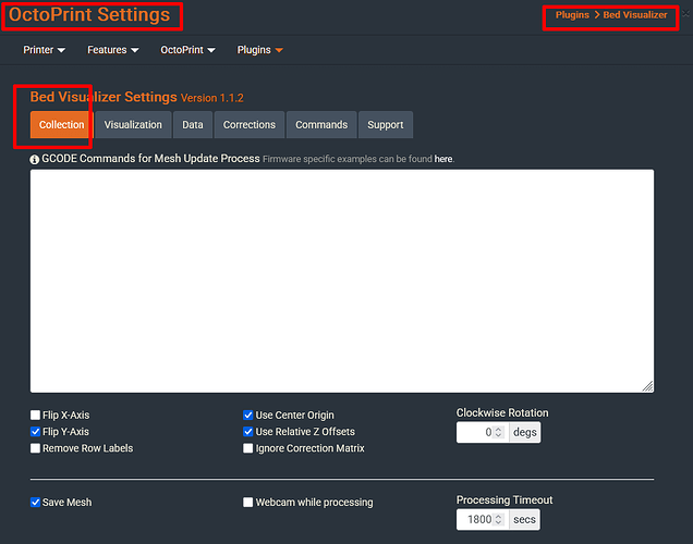

What commands have you setup in the Bed Visualizer plugin?
I don't change the default Bed Visualiser settings, but I suspect it doesn't matter. After I submitted this report yesterday, I discovered two patches by the board manufacturer, both of which concerned using the BLTouch sensor--without the patches, the board was trying to use it's own levelling process. Once the patches were installed, Octoprint levelling worked as it was supposed to.
