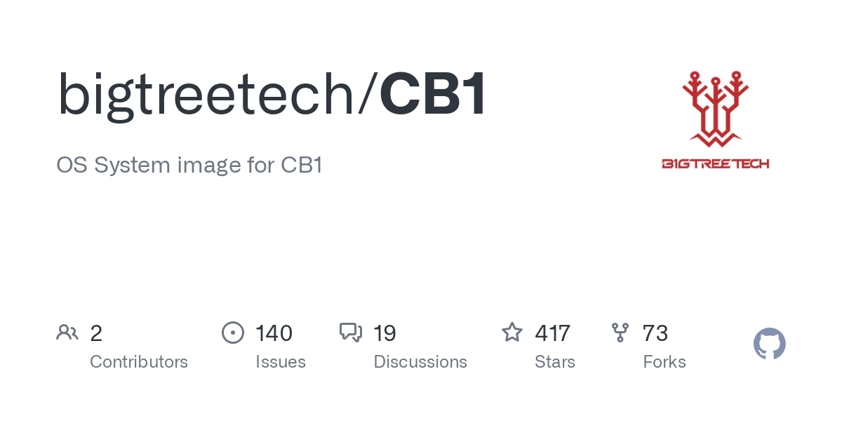

The pad itself is driven by the CB 1 board which is supporte by armbian (the BBT guys also use armbian on their image).
So it shouldn't be a big issue to install a fresh armbian on it and to use it to run OctoPrint. The more difficult part is the screen. I can't tell you for sure how it's connected, but the release notes to the image indicate that it's just using hdmi - which would make things easier.
You can also use their minimal image which should include all the needed things, but doesn't come with klipper preinstalled. IMO the best option to start.
