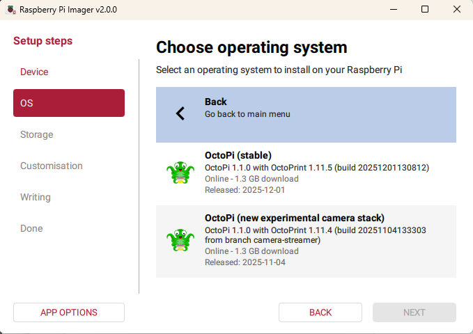

On the RPi 4, the Camera Module V3 is currently supported in OctoPrint on the "cam" version of OctoPi. I have this configuration.
Note: On the RPi 5, there currently is no OctoPrint compatible support.
Thanks for the reply,
What would be the easiest way to switch over to this version of Octoprint? Could I just make a backup on the current version?
Yes, make a backup on your current version, download it, create the new image (on a new microSD card if possible), boot the new image, and restore the backup.
I recommend a new microSD card so if something goes wrong, you can recover by returning to the old card.
I also recommend keeping the username as "pi" but if you changed it on the current version, make sure to use the same username on the new one.
