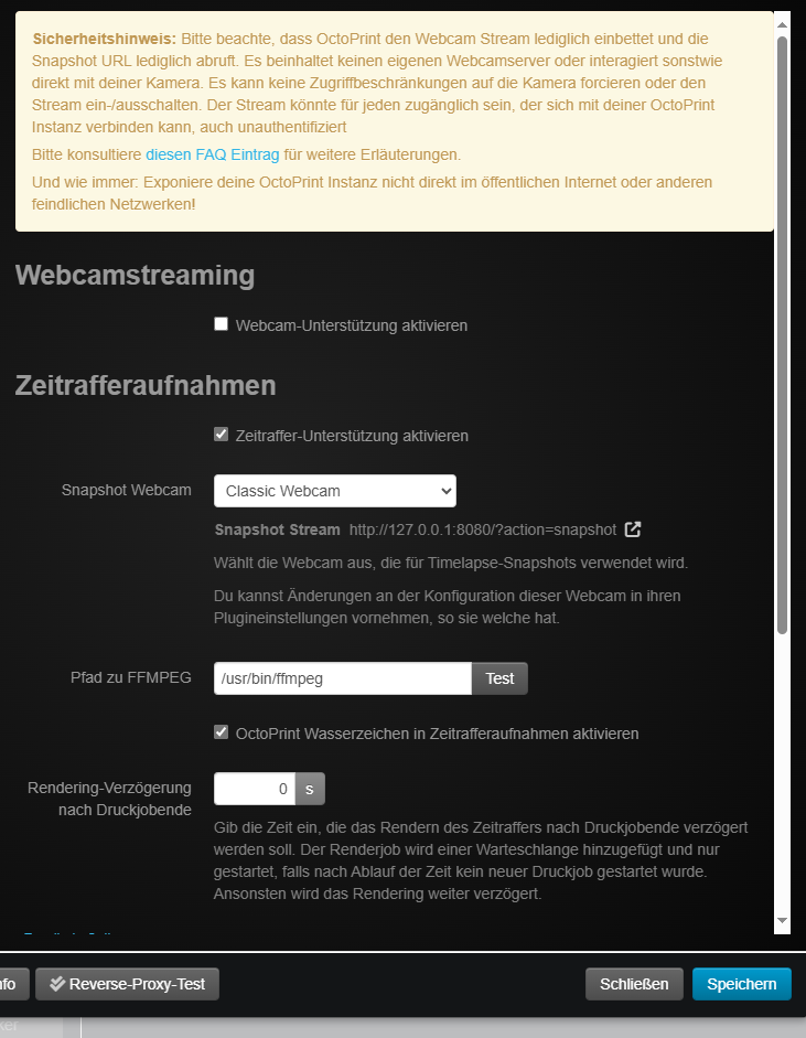

and all Settings:

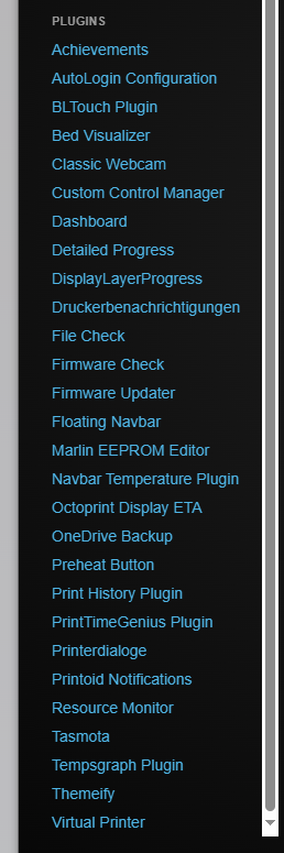

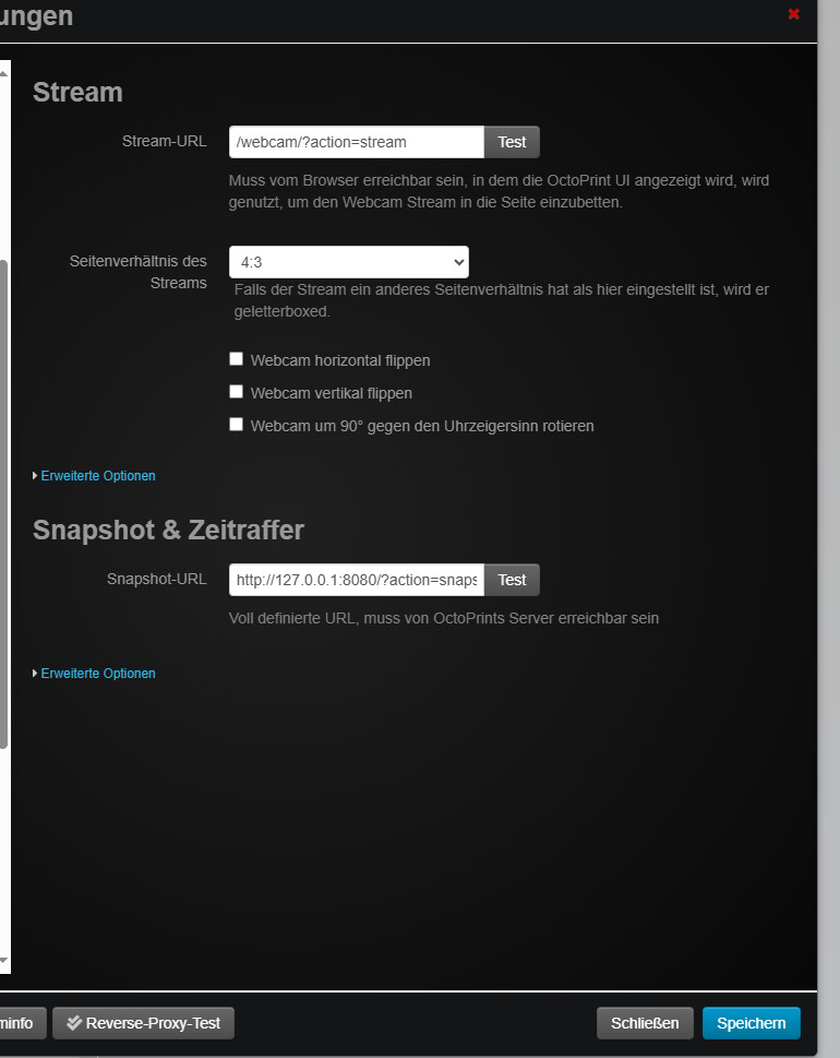

I have found the Webcam Iframe plugin, installed but where is the setting?
Enter the full URL for you mediamtx setup in classic webcam settings.
