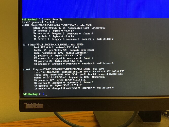

I’m not at all proficient with Linux command line, but I followed your instructions. At the second menu, when I selected “S1 wireless lan”, it did not ask for a country code, it immediately asked for SSID, and then password. When I hit return, it went back to the previous menu. I selected Finish and was back at the command line. When I entered sudo ifconfig, I got the attached screen. I’m not sure what all that means, except it doesn’t appear that it connected.
Seems to be connected
Try http://192.168.0.104 or http://192.168.0.104:5000 if you don't use a reverse proxy
That worked, thank you. It would have been much easier if http://octopi.local would have worked like in all the videos I watched. Thanks again for your help.
