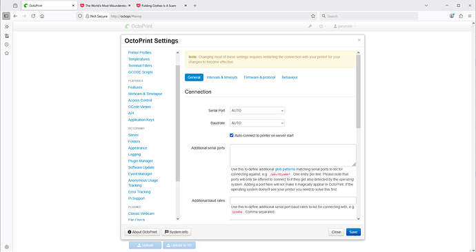

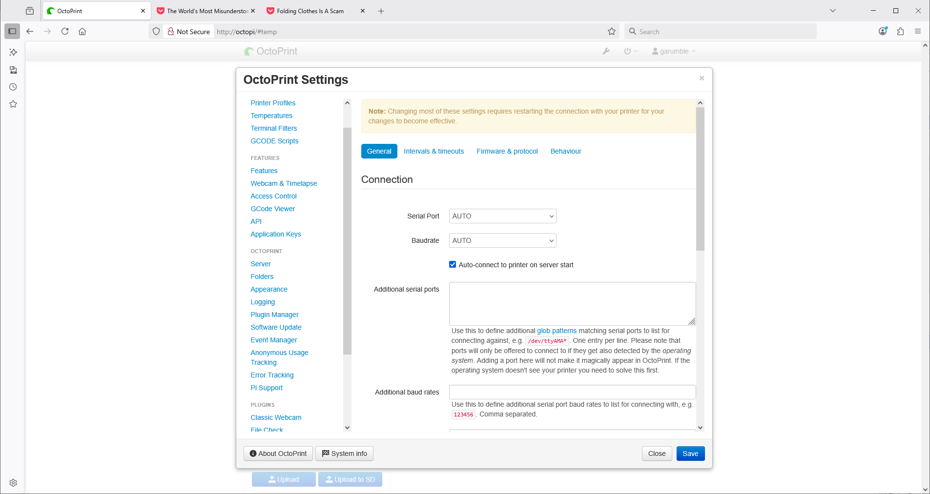

I don't appear to have that.
You are correct. Examining octoprint.log in the bundle you provided shows that at some point in the past you had it but more recently, there is an error loading the plugin (as shown below).
It is going to take someone with more intimate knowledge to determine if/how you can recover from this failure.
