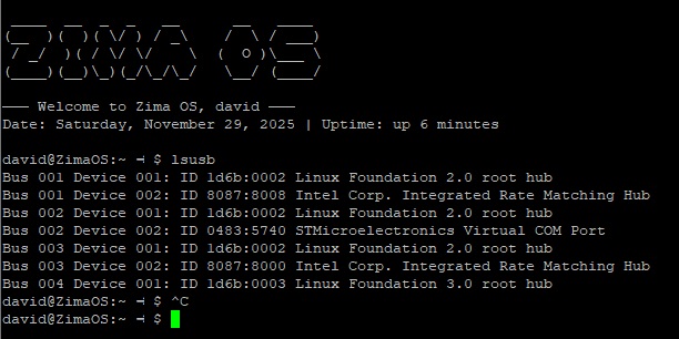

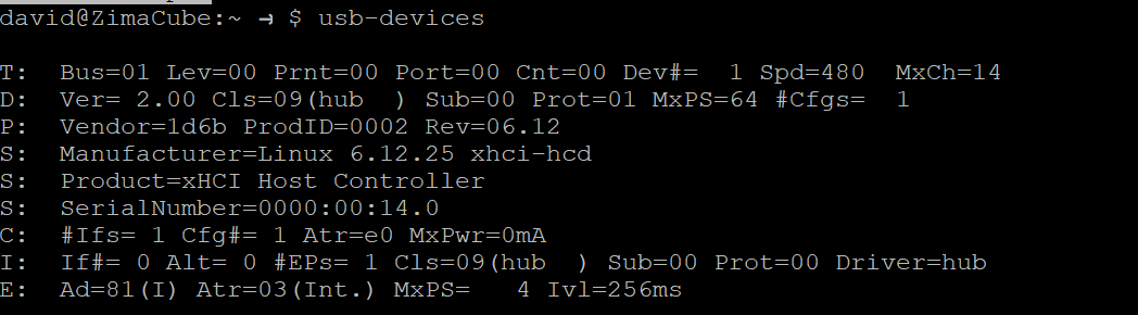

I have run usb-devices and can see that my server sees it, but it wont connect.

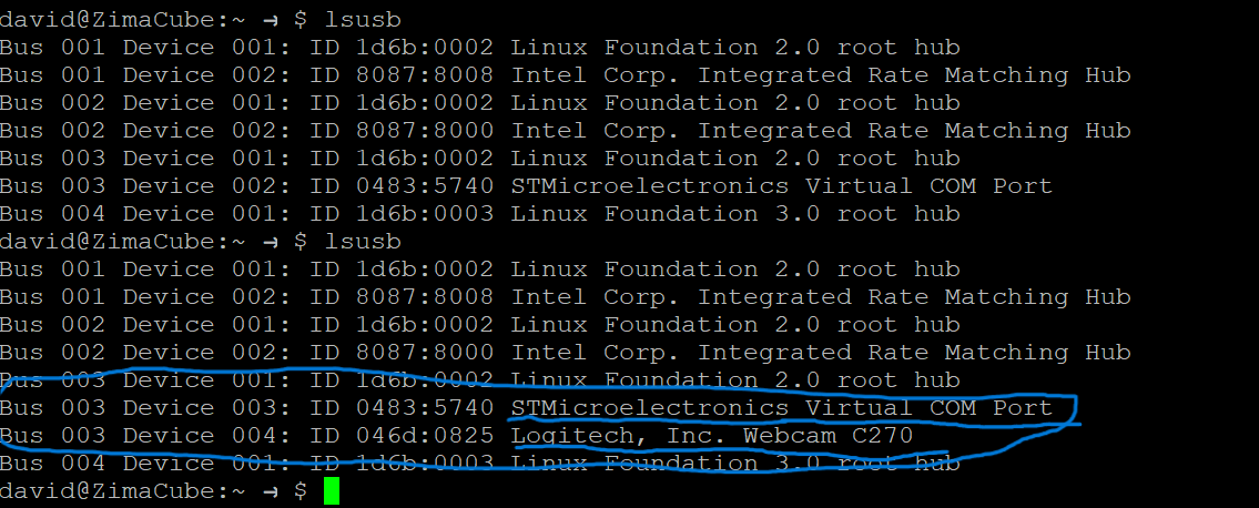

When I run lsusb it shows the cr10 printer as STMicroelectronics Virtual port, I know that's my printer because it doesn't show when I unplug it Under that is the Logitech camera I plugged in. Doesn't this show that the usb ports are working? I still can't connect to the printer.

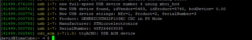

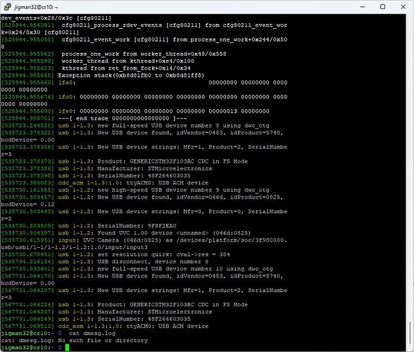

The first image is from being connected to the raspberry PI that I have been using for years, It works great.
The second one is being connected to my zimaos server. This is the one I am trying to get working. From what I am seeing they show the same for ttyACM0, but the raspberry PI works and the zimaos doesn't.
