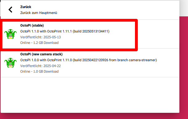

You should use OctoPi 1.1.0 then.
grafik
Thanks for the suggest. I have tried both Octopi 1.1.0 and the camera optimized installation. Have also tried flashing image with BalenaEtcher. None of these approaches have fixed the problem.
