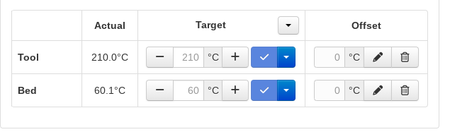

I'll upload a system info bundle as well as a screenshot of the temperatures when it was paused.
Screenshot 2025-04-10 3.48.12 PM

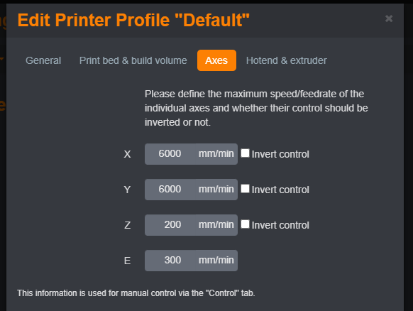

you were doing this from OctoPrint's control tab? only reason the commands would show in the serial.log as sent would have been if it was sent from OctoPrint I'm pretty sure. if that's the case, F300 is coming from your printer profile settings in OctoPrint and would make sense as a default value.
I would be interested in knowing what the default EEPROM value for max feedrate would be. In the terminal tab of OctoPrint send the command M203 and what is returned?
Recv: M203 X300.00 Y300.00 Z10.00 E60.00
Yes, I was using the Retract and Extrude buttons on the control tab. I set it to 100mm to unload and extrude, and an extra 20mm to finish clearing out the other color.
Updated system info bundle:
octoprint-systeminfo-20250410194422.zip (665.3 KB)
And sadly, still no extrusion.
Ok, M203 reports mm/s, whereas the setting in OctoPrint's printer profile and in movement commands (G1 G0) are in mm/min. So if we take your max numbers are multiply by 60 that should give us the correct values.
300x60 = 18000
10x60 = 6000
60x60 = 3600
keep in mind these are max values, so settings these lower in OctoPrint's settings isn't necessarily a bad idea.
when you did this, was the retraction and extrusion doing anything at all? seems like that would not be the case if the speed was being set to 300 instead of a higher number like 2500 or 3000. using 4500 would just be hitting the max limit and keep it at 3600 in theory.
