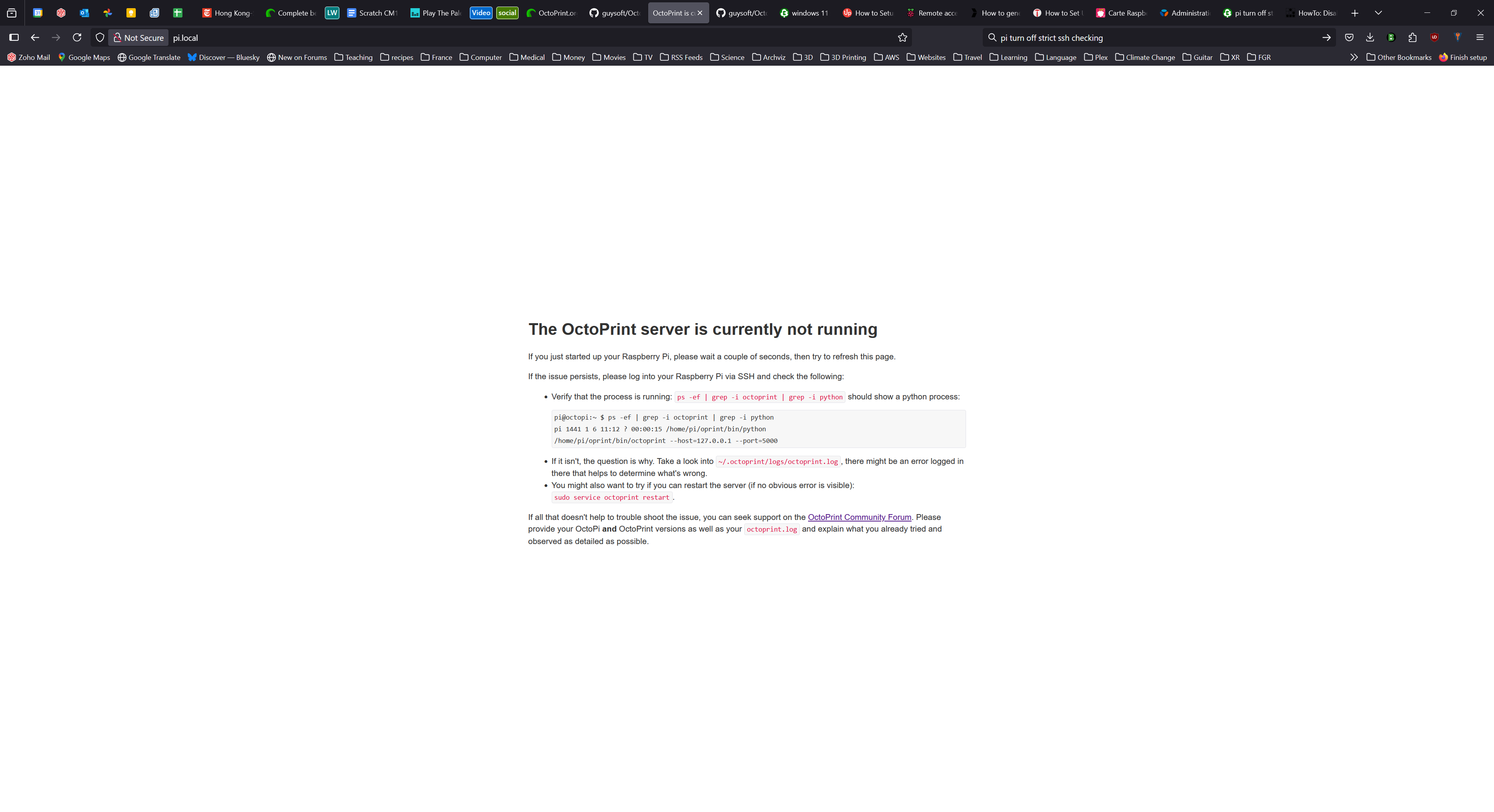

This is what I see:

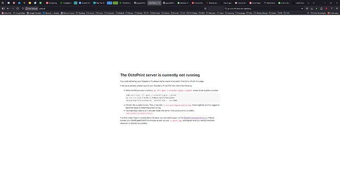

So, on the troubleshooting steps shown on that page:
If the issue persists, please log into your Raspberry Pi via SSH and check the following:
  • Verify that the process is running: ps -ef | grep -i octoprint | grep -i python should show a python process:
pi@octopi:~ $ ps -ef | grep -i octoprint | grep -i python
pi 1441 1 6 11:12 ? 00:00:15 /home/pi/oprint/bin/python
/home/pi/oprint/bin/octoprint --host=127.0.0.1 --port=5000
  • If it isn't, the question is why. Take a look into ~/.octoprint/logs/octoprint.log, there might be an error logged in there that helps to determine what's wrong.
  • You might also want to try if you can restart the server (if no obvious error is visible): sudo service octoprint restart.
If all that doesn't help to trouble shoot the issue, you can seek support on the OctoPrint Community Forum. Please provide your OctoPi and OctoPrint versions as well as your octoprint.log and explain what you already tried and observed as detailed as possible.
I tried the ps line and it just comes back to the prompt
I tried looking for logs (there's no log folder) and restarting the server, which just returns and the webpage still shows the same.
