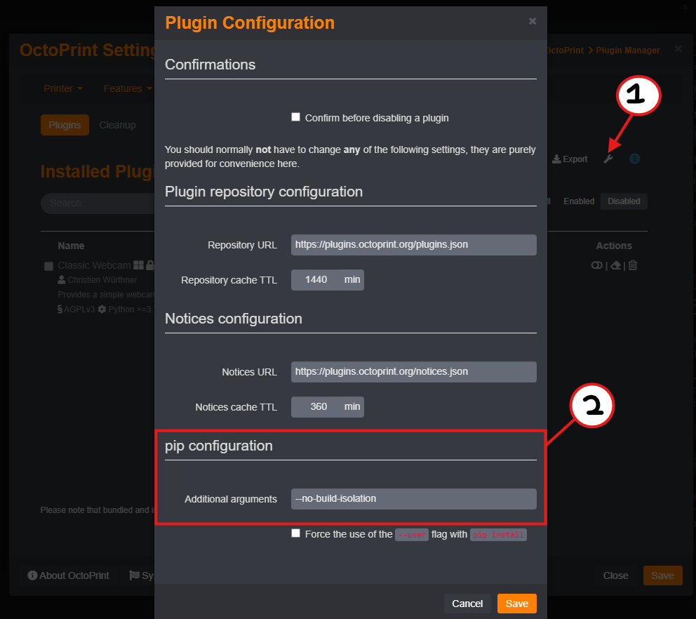

someone else found a potential fix in discord. they were able to install with an additional pip argument. try adding --no-build-isolation to the pip configuration.
I'll take a look, thanks.
I don't see that screen…it just goes ahead with an install with predictable results. Where would I do that on the command line in the venv? Just add it to the existing command line?
python3 -m pip --disable-pip-version-check install .  --no-cache-dir --no-build-isolation
