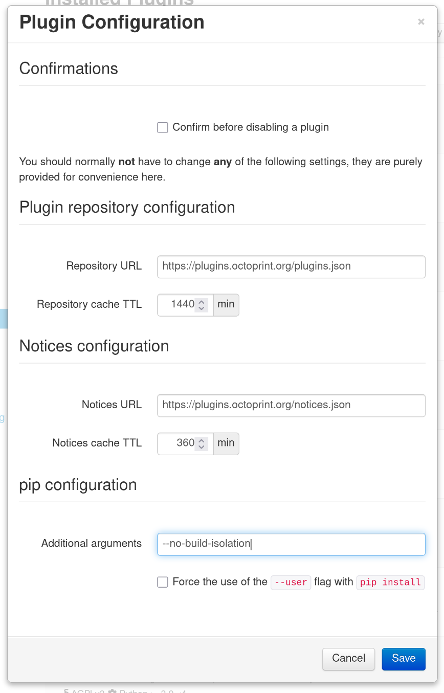

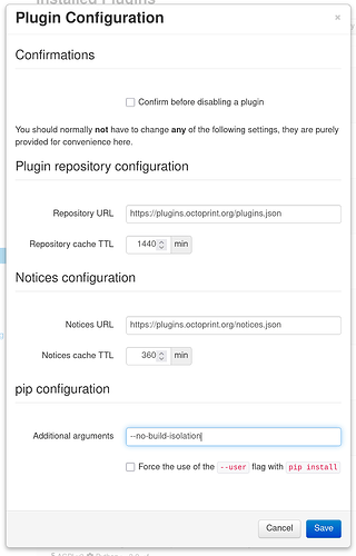

  1. tell OctoPrint to install plugins via pip with the --no-build-isolation parameter by adding that to the additional pip arguments configured for the plugin manager under Settings > Plugin Manager > wrench icon
