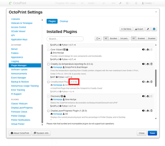

Raspberry Pi 3b+ after installing OctoPrint installing Creative Cloud plugin after activation reboot the plugin is disabled

It was 1.0.8 after download, but after reboot it showed 1.0.9

Hi, I tried to install this https://github.com/crealitycloud/OctoPrint-CrealityCloud/archive/refs/tags/1.0.8.zip
But it changes back to 1.0.9 on installation
