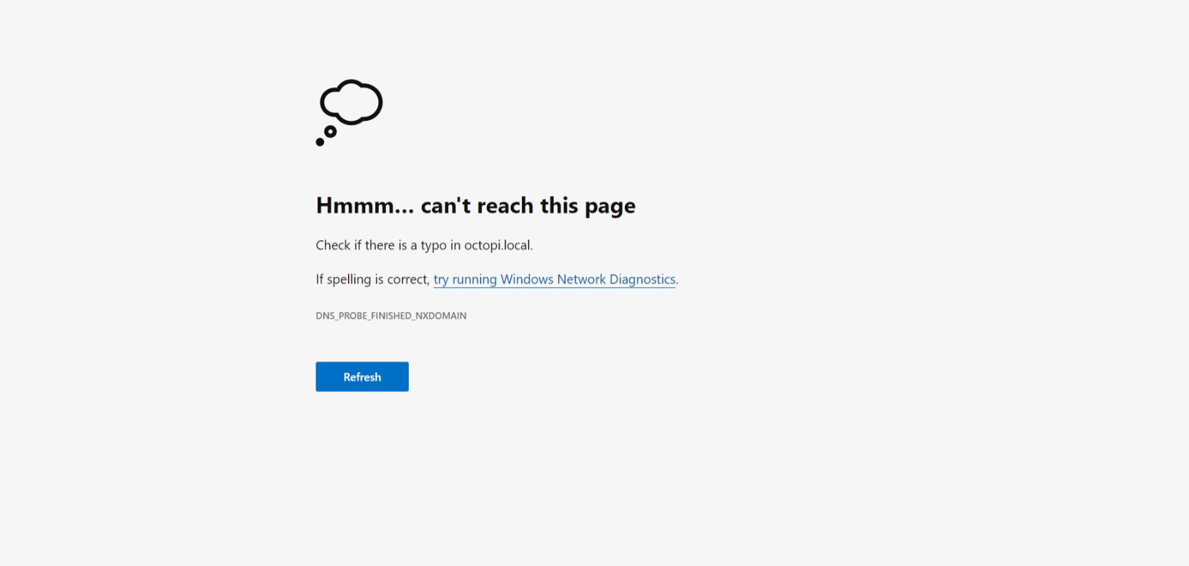

but still having issues with getting it to connect to my home router. cant find the octopi.local to get it to work. router doesnt show it as an user either.
Have you edited the octopi-wpa-supplicant.txt file to add you wifi network SSID and password? This is required before Octopi can talk to your wifi. Also be sure to uncomment the lines in the WPA/WPA2 section by removing the # marks.
Details on setup found at https://octoprint.org/download/ in the Setup section.
Ewald_Ikemann i tried that with same results. Thank You
egar, yes ive done those steps . even added in the scan_ssid=1, still no luck ... im begining to wonder if i dont have a bad RPi ... my router will not pick it up at all
