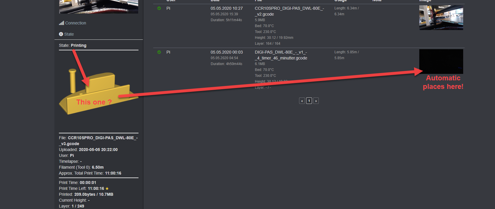

Seems like there is an image - just very dark.
Isn't the blue thing your display?
Then I start the print job, a thumbnail is show up in the left menu. Can This image automatic be placed in til “Print Job History” ?
That looks like the UFP plugin's extracted image based on the proportions and file name. In the case of either that plugin or the PrusaSlicerThumbnails plugin the metadata will have an extra property named thumbnail. @OllisGit would have to integrate it within his interface.
Looks like Olli already has opened an enhancement-issue regarding the thumbnail integration
Cool, didn't know.
Hi @stonefox,
if you want to use the Thumbnail instead of the Snapshot-Image you need to deactivate the snapshot-checkbox in the plugin-settings. Because the taking a snapshot has a higher priority.
