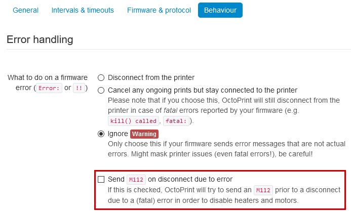

Enable serial logging in the printer settings of OctoPrint and recreate the issue then share updated system info bundle.
Quick google seems to return many examples of custom firmware with this error and the suggestion by those maintainers (not the OctoPrint's maintainers) is to disable OctoPrint's safety features.

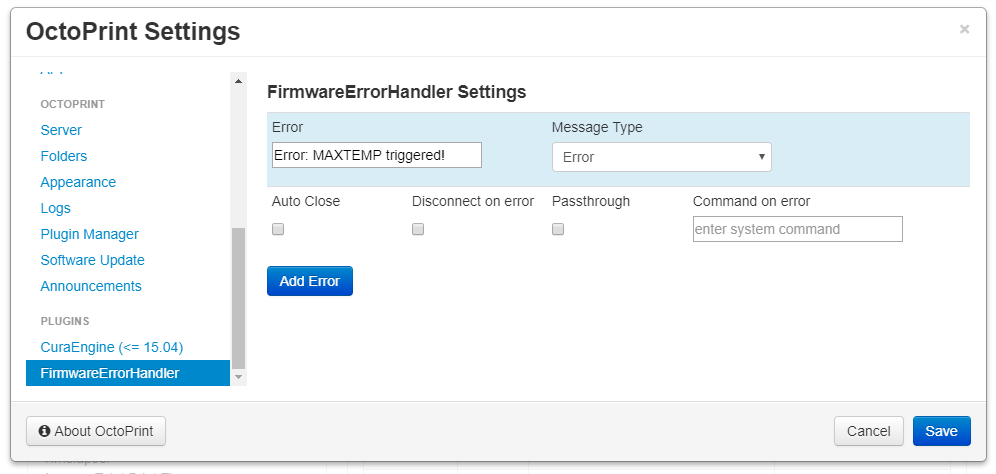

The potentially safer option would be to leave those settings alone and then install my FirmwareErrorHandler plugin. Then you add the specific error to ignore.
Put 'Error:Serial status mismatch' in the Error field
