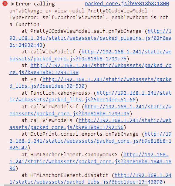

Screenshot 2024-01-08 225349
Screenshot 2024-01-08 225403
Try disabling the 'Pretty Gcode' plugin. Based on that error it's causing a problem. I also have a vague recollection of seeing this before.
Booted into safe mode and got this whenever I inspect the "test image" location
