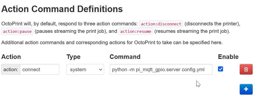

i would like to run a script whenever Octoprint is on or connected to the printer.
i thought this would work but it does not!
what are my options?

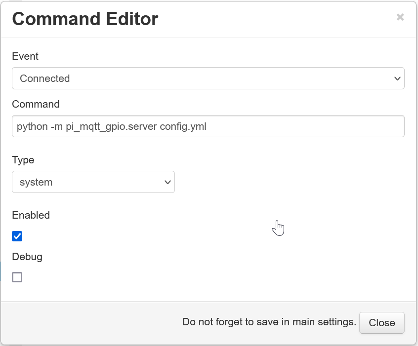

i tried cron job too via these commands from a website but did not work as well:
crontab -e
choose nano, if first time
@reboot sh /home/pi/filament.sh
exit and save
sudo nano filament.sh
paste in:
python -m pi_mqtt_gpio.server config.yml
exit and save
sudo chmod a+x /home/pi/filament.sh
sudo chmod a+x /home/pi/config.yml
off course if i run manually in Putty, it works:
As a start use the absolute path to your yml file.
you are right! updated in Event of Octoprint. no need for cron nor plugin. thanks!
