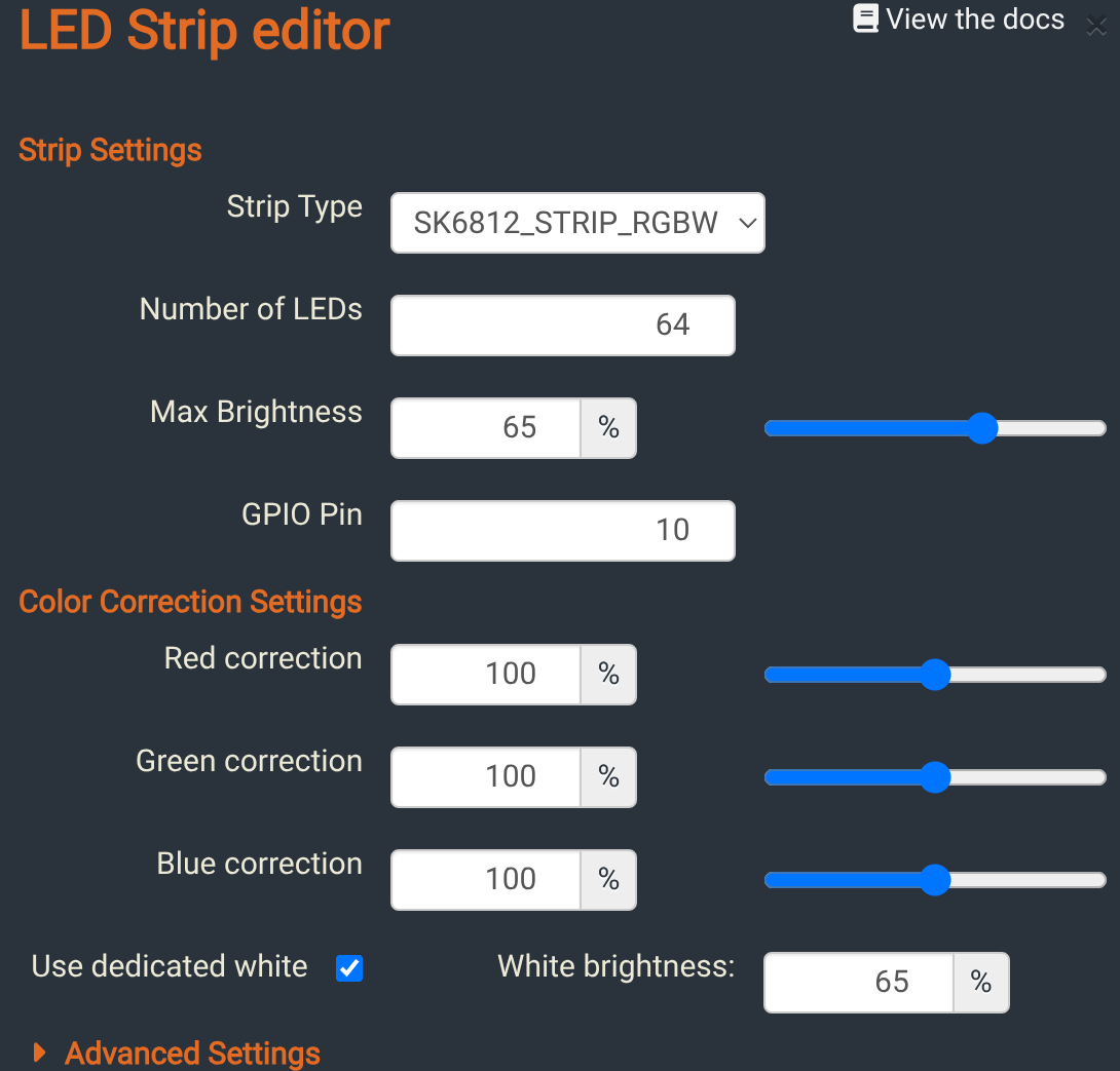

I just looked up my settings. I use the wiring scheme without level shifter and a 5V phone charger as power supply. See the screenshot for the plugin settings for the LEDs.
