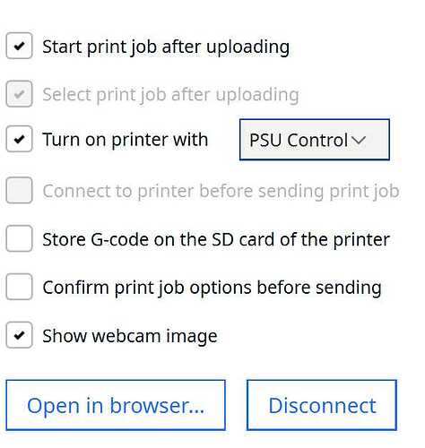

In Cura I have this option set. So I presume this would trigger something in the log right? Turn on printer using PSU Control ?
If it can turn on I'm sure it can turn off and visa versa .. Anyway I can't do nothing until someone advises me where this log is located please .. I'm going bed again in frustration....

when debugging is enabled it will write lines to the octoprint.log file lines like Switching PSU On and Switching PSU Off when clicking the icon in the navbar or with that option in enabled in Cura. One quick question, is your printer LCD powered by the USB when the printer is off (backpowering)?
ok, I'm an idiot. I just noticed your PSU Control settings. Your switching method needs to be changed to the Tapo sub-plugin for it to function properly.

Thank you for suggesting the method of switching to the plug. Because of this, my printer now turns on when I send a print job from Cura, which is brilliant. I've just finished a test job, and it turned off automatically afterwards. This is fantastic!
A special thanks to jneilliii for identifying the problem, and my gratitude to everyone who contributed to the thread. I'm absolutely thrilled with this outcome. This was the main reason I wanted to set up Octoprint, and now not only is this working, but I'm also reaping all the other advantages that come with having an Octoprint server.
