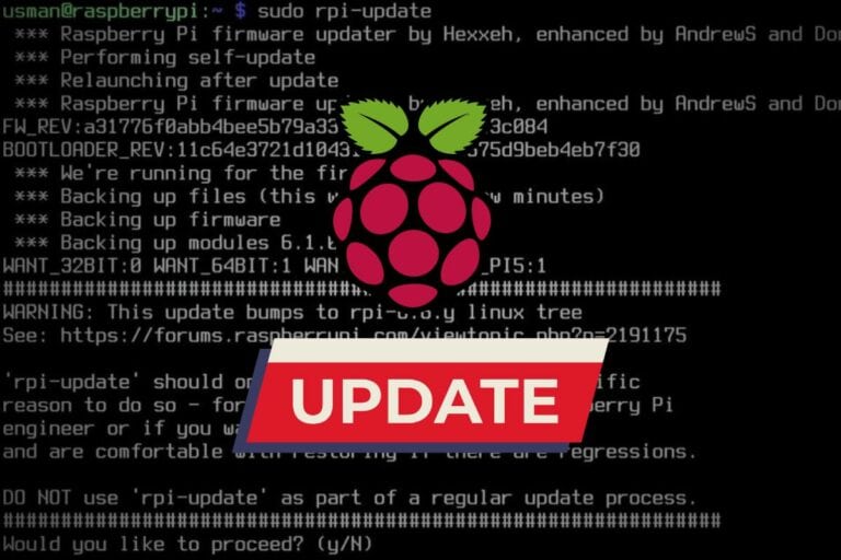

maybe there is something helpful?
I did use rpi-update to bring the kernel to 6.12 in the hopes that it would fix it. I believe it updated the firmware too.
